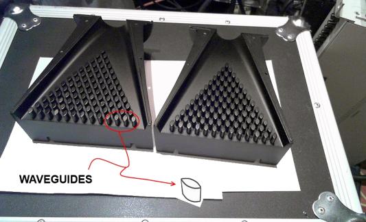

You might try to DIY yourself a slotted acoustic lens for the 1.4".
Check pics in the review comments to see the lens structure inside.

Member Kenpeter has some good points about 12" drivers and their inherant faults. These are worse with a 15" crossed over to a HF driver as a two way system. Nexo, in fact, resisted for years offering a 12" 2 way system - but when they did, they used a phase plug we affectionately nickname the "dogbone". Look at it on their Geo S12 system, illustrated on pg 3 of this:
Welcome To Nexo - Nexo
Very effective, and simple, without as many of the potential resonant artifacts of fully slot loading the driver.
