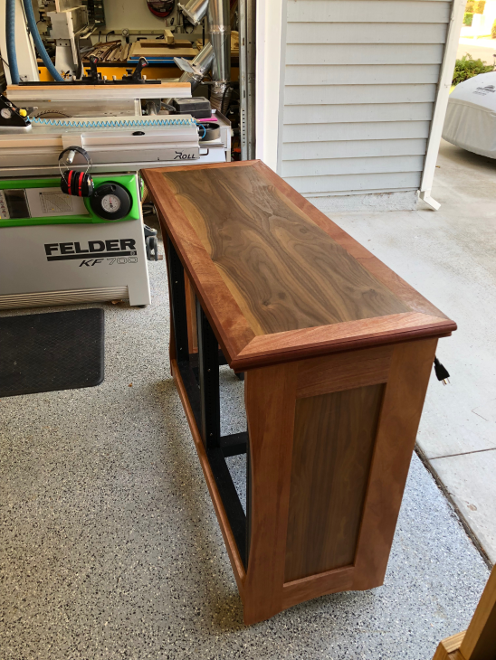

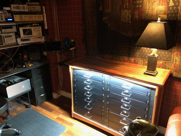

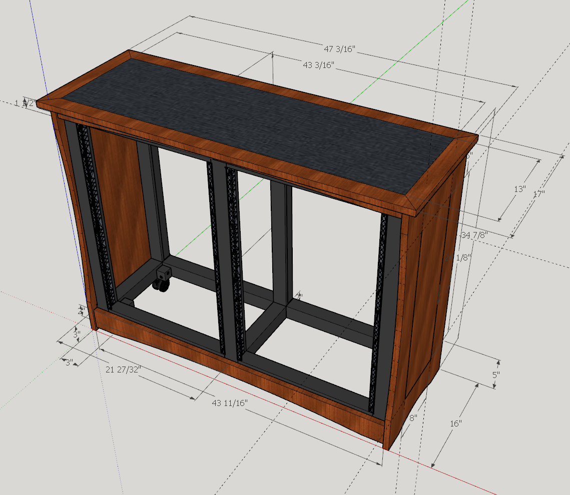

16U rackmount
Here's a 16U rackmount that I built to house equipment and drawers for my lab. PM me if you'd like the sketchup model, so that you can modify it to your needs.
