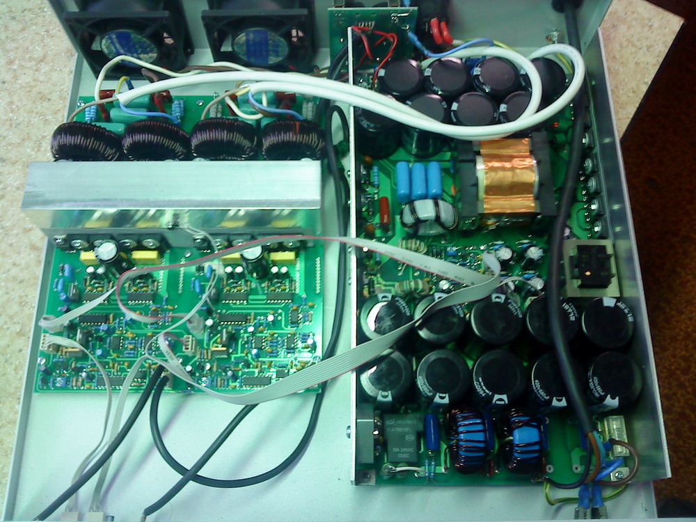

realization 8 Ohm is 1000 watts .
full bridge
lm311 , 72AC00 , ir 2010 ,irfp90n20 f-200 kHz
90v (rms) 4 Ohm
80v ----- 2 Ohm
98v------8 Ohm
per 1 channel f- 400 Hz
lim-lm13700
