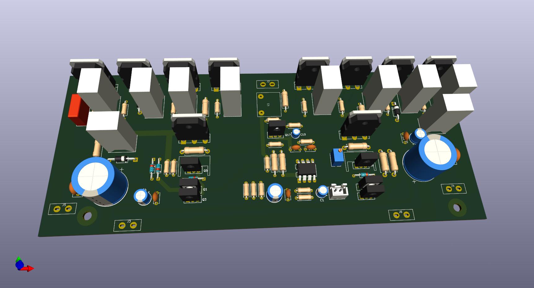

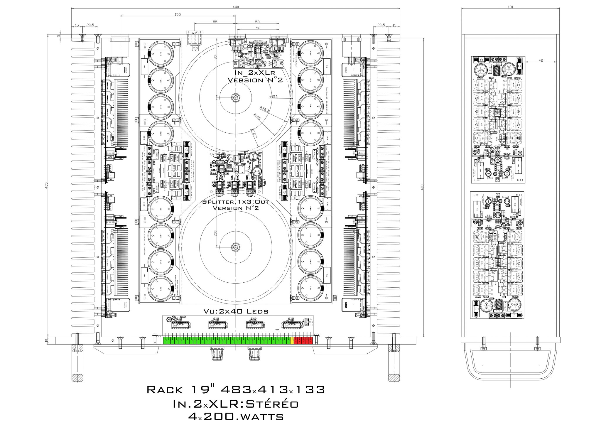

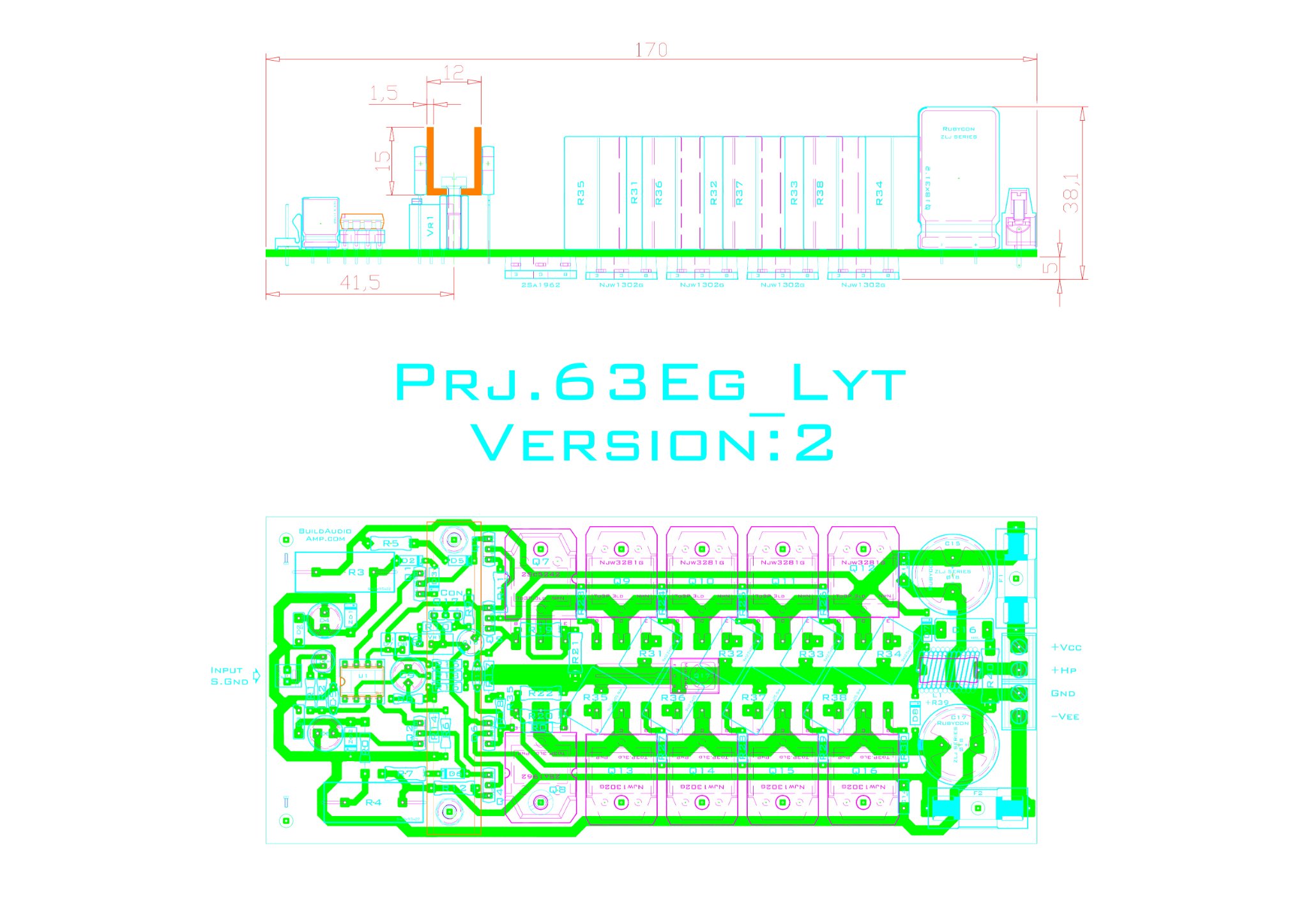

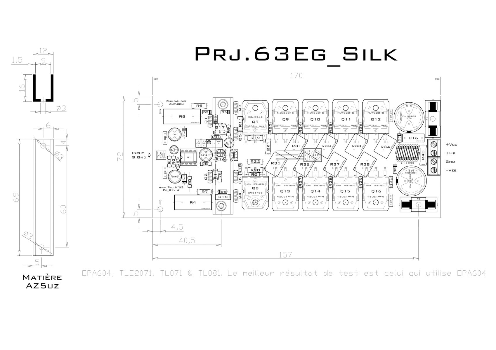

Starting construction of project #63, my version. Yes, yes!!!
Pictures of the design from EG to AD!
Bye, bye.
