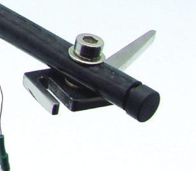

FYI,
I used only "ordinary" (dur) Alu tube dia 10mm and with a inside inner bar (dur) Alu dia 8mm (non magnetic).
For the alu bar 8mm; with a fine file (zoete vijl) bring it "perfect" on 1/2 dia (for a old mech ingineer with ordinary tools no problem ).
I use (2) brassing (Cu) screws (non magnetic).
Allez, salukes en vriendelijke groeten,
Karel
This seems really simple and effective.
It's a unipivot by Consonance.

WOW! That is such a simple design and very usable across different types of turntables.
It has me thinking :bulb: about trying to adopt this type of headshell for older Dual turntables because a new Dual headshell costs about $30-$40 and I just can't see spending that much $$$ to have multiple cartridges to change in and out on my Dual 510.
