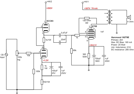

300B + Hammond 1627SE ??
I've finished my first SE project with a KT88 and I am very happy with the results, but I'm curious about the sound of a triode, so I want to try the 300B and find for myself the truth and lies about it
Since my amp is "modular" I just have to change the module of the valves keeping the PS and the OT to change to a new design (I'm preparing a connector to fast-change in between the different designs).
There are many schematics for the 300B but, do you know some specially designed for the Hammond 1627SE transformers?
I'm asking this because the schematic that I did choose for my KT88 amp was originally designed for a Tango, and I had to made few modifications to adapt it to the Hammond's.

Re: 300B + Hammond 1627SE ??
Konnichiwa,
Not really, but in order to get some measure of consistence, you might wish to keep the circuit as similar as possible. I'll comment more below.
Not surprised. The circuit you choose uses two feedback loops (one around the output valve and one around the whole amplifier) and has a rather interesting approach to compensating the Amplifier against oscillation. In THAT PARTICULAR circuit changing such an essential part as the output transformer can make the amplifier instable.
Now I would recommend to try both the KT88 Tiode wired and the 300B WITHOUT negative feedback. Your circuit has all essentails in place.
I would suggest removing the 1K5 feedback resistor and connecting the screengrid of the KT88 to the anode via around 100 Ohm (BTW, this 100R screengrid stopper is almost always neccesary to keep such an amplifier stable and from osciallating, I'm surrised it is missing in the original schematic) and removing the capacitor on the anode.
This gives an Amplifier with the KT88 that is SE, triode and zero feedback. The 300B can drop into the position as the KT88 with only the cathode resistor and cathode capacitor adjusted (used 750R/50W & 100uF/160V, same brand and type as present on the KT88 for R&C).
Also, you will need 5V DC for the 300B heater and the quality here is absolutely critical to the sound. You MUST use schottky rectifiers and sensible types of capacitors and you MUST add a few layers of LC filtering, especially common mode filtering, for the differential mode filtering you can use a gyrator. In the 300B cathode and Heater are one and the same, so the heater supply is also part of the audio signal circuit, get it wrong and the result can be very bad.
Now it would be far from me to claim that either amplifier is optimal or ideal and I would not consider either a vehicle to judge the absolute attainable quality available from any given valve, HOWEVER, it will give you the option to judge the RELATIVE sound, compared to each other.
Sayonara

Thank you very much for your suggestions. I will start studying this new approach this weekend. First I will start this modifications for the KT88 circuit.
If I do this the KT88 will work as a triode, like at the Ranier zur Linde schematic . Am I right? I like to try that.
Ooops, I'm sorry but I'm lost here
Then I will love the 300B, since I'm not using "refined" or expensive components: orange drop caps, Tube Amp Doctor electrolytics and standard resistors. To be honest, I'm not concerned about "purity" of sound, so if the amp adds some flavour that sounds good to me I will enjoy it with no worries.

...connecting the screengrid of the KT88 to the anode via around 100 Ohm

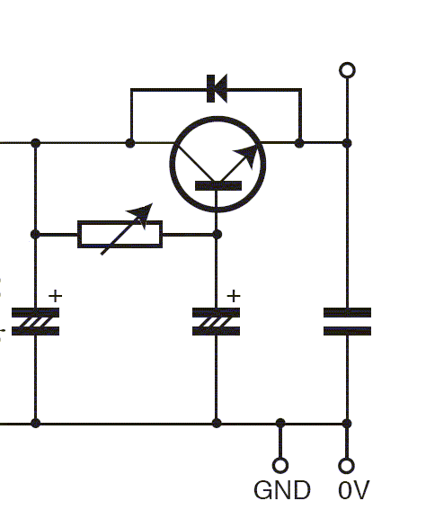

Konnichiwa,
The RZL Schematic shows the option of triode and pentode operation option. However, it retains negative feedback in a "long loop", which I find less than desirable. As said, i'd just leave the feedback out completely....
In fact, the schematic I'd recommend for the driver would be closer to the one shown below, keep your powersupply as is and increase the coupling capacitor to 0.47uF and of course triode wire the KT88:
BTW, using an "orange drop" cap as coupling cap is okay, as long as you make sure it is a film/foil type. If not, I'm sure there is a Radio pares (www.rswww.com) subsidary in Spain who can supply the Arcotronics KP1.72 capacitors, which I like as comparably sonically neutral parts for coupling (eg. go to www.rswww.com and enter part number 114-626).
What is also worthwhile doing is to return the cathode of the power valve to ground through the correctly phased speaker secondary. This applies a small amount of local negative feedback and can be combined with pentode mode or ultralinear to give higher power, but usually does not sound as good as triode mode, despite the lower power of triode operation.
Okay. Well, here a short description of my "preferred implementation" for a 300B heater supply:
1) Mains Transformer 9V+9V >> 1.5A (a 30VA torroidal transformer should be okay)
2) Dual schottky rectitier diode 30A or the like for a fullwave rectifier
3) Small value series resistor (around 1R, exact value to be tuned in circuit to adjust the DC on the heaters of the 300B to 4.875V exactly, at nominal mains voltage).
4) 4,700uF/16V low impedance electrolytic capacitor (Panasonic FC/FAseries recommended)
5) 1pair of 3.3mH Air Core Chokes (speaker crossover parts) or better a specially made > 0.1H/1.5A filter choke, the total DCR of the Choke(s) should be < 1.6R
6) 4,700uF/16V low impedance electrolytic capacitor (Panasonic FC/FAseries recommended) in parallel with at least 10uF MKP or MKT
7) Common Mode choke with at least 2A rating and as much inductance as yiu can get
8) 10uF MKP or MKT capacitor directly in parallel with the heater at the 300B socket
The large value choke(s) can be replaced by a circuit commonly known as "gyrator", which is a little incorrect. It uses an NPN Power Transistor (like 2N3055) with a resistor of a few 100 Ohm from collector to base and a capacitor a few 1,000uF from the base to ground, positivce supply line into the collector and output from the emitter, like attached, adjust the resistor between collector and base to give the correct voltage under load....
Some people use 3-Pin regulators, if you like use these but make sure they are good quality LM/LT1085 minimum and you will need some really high quality capacitors (Sanyo Os-Con recommended) around the chip (input and output capacitor plus bypass on Adj pin). I still feel that the transistor filter or a real choke sound better.
Another hint, a hot 300B heater is nominally a 4.17 Ohm Resistor. Use five paralleled 22R/2W resistors as dummy load during building & testing and allow the voltage to be slightly high, finetune with real 300B's at the end.
