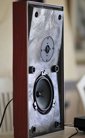

Let me say it again. A B&O P30 wallmounter is entirely different from a standmounter like the regular Classix II.
A wallmounter needs far less bass bafflestep boost than a standmounter. Paul Carmody's Classix II will sound terrible and overly bassy wall mounted. It's just how it works. 🙂

Steve, those B&O P30 are horrible ! How can you put a reflecting surface at 10 cm from the cone ? You kill it !
I do get a bit tired of explaining why I like any particular design. 🙂
Let's look at the tried and tested B&O P30:
This is a slim wallmounter. Being wallmounted, it doesn't need huge 6dB bafflestep boost. Anyone who doesn't understand that, please leave the room now. 😀
TBH, we don't often do wallmounted these days. But it's an interesting idea.
