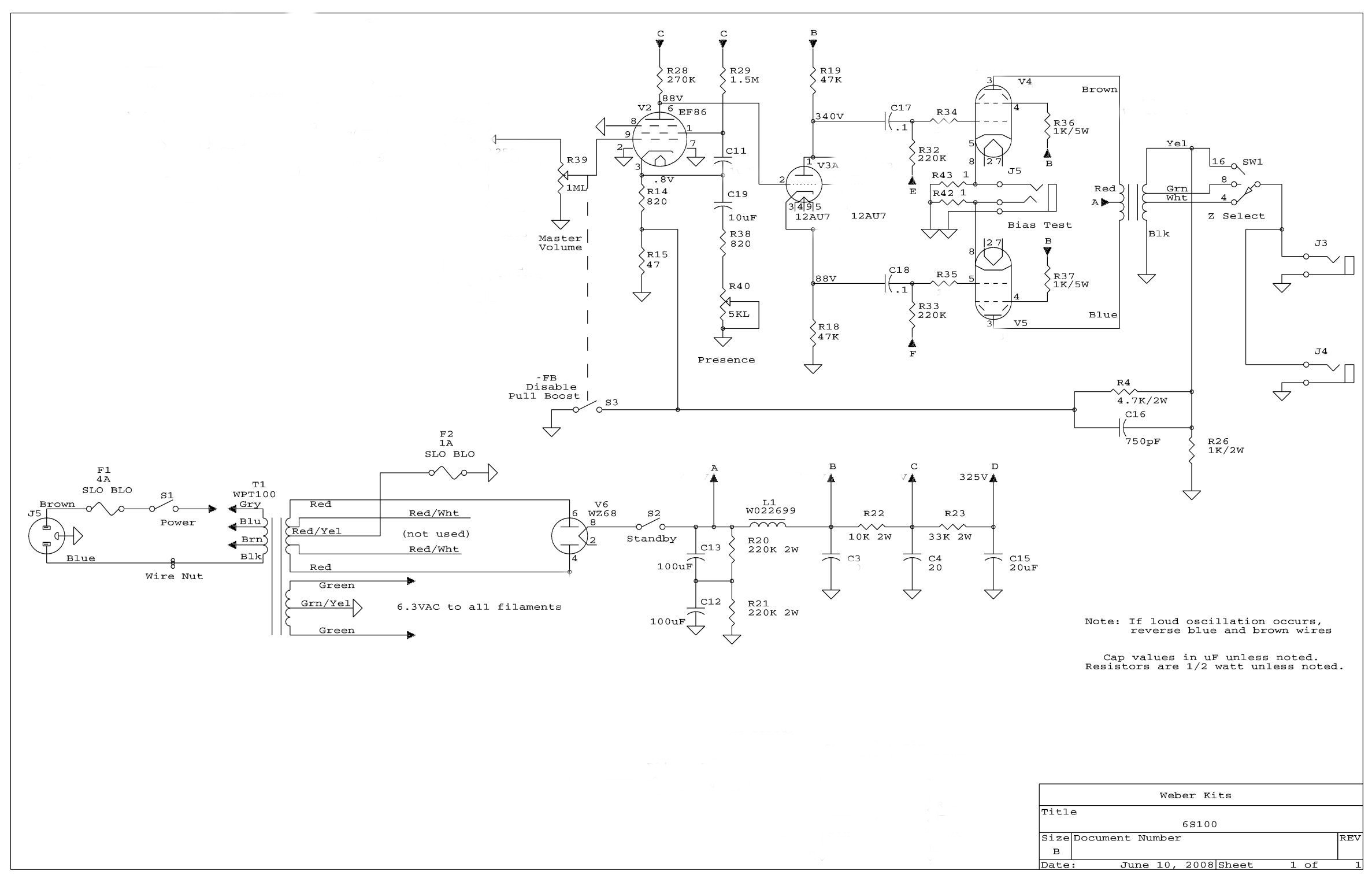

The amp has worked and performed, for the most part, as desired; Until recently.
This amp is based on a stereo build version of the Sunn S100. I used Webers schematic with some basic changes. One of which is the bias circuit. Before I go through the trouble of editing the schematic to reflect the changes, I have a basic question related to the bias circuit, which is in it's 5th redesign. Here is the problem currently under analysis:
The output tubes are 6L6. Using the 1 Ohm cathode resistor measurement method, I can adjust the bias output to various values within the desired range all the way through to the grid resistors. However, the actual value at the 1 Ohm cathode resistors ends up being 2x the bias setting. How can that possibly be? With the output tubes removed the bias value all the way to the grid resistors reads the same as the bias output setting. However with the tubes in, the bias setting seems to double.
Thank you for any assistance you may have to offer,
Colorcat.

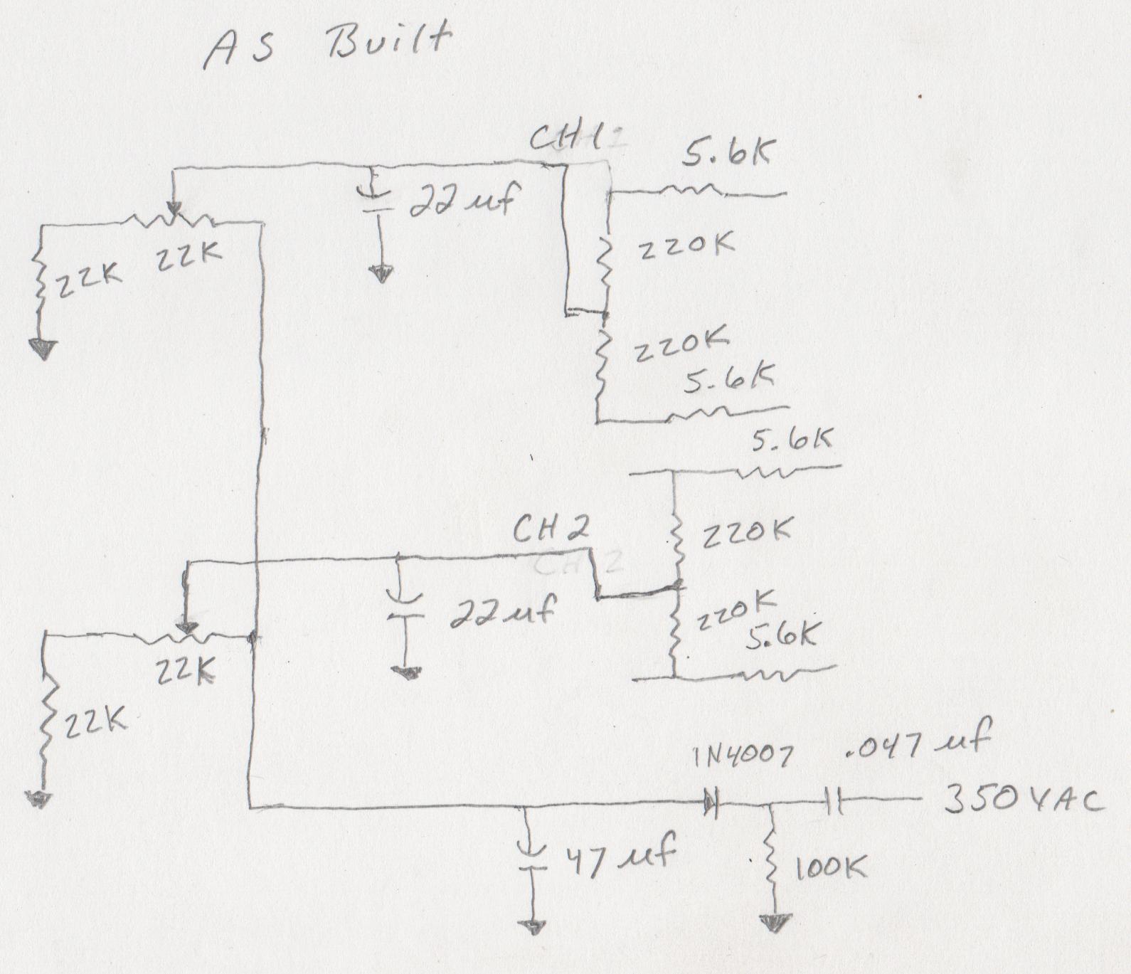

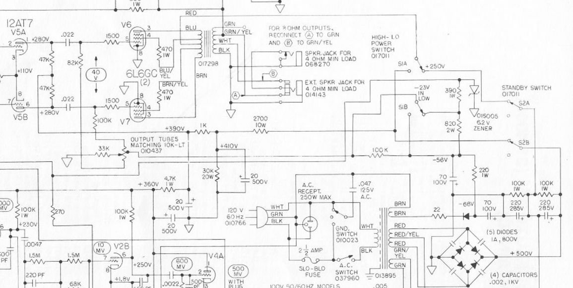

This is what I've done
The following schematics indicate the changes in the bias circuit and the application of the design to my build. I've already gotten some clues after looking more closely at the original design application. The bias feed is different in the 6s100 implementation for one. Adding a second channel dropped the base load resistance of the bias output voltage. The 22k base resistance needs to be raised to something like 100k. There are notes regarding the setting of the bias on the Carvin schematic that I missed when implementing the circuit.
I still do not understand how I got 68 ma of tube current when the bias setting was -32 volts. (The bias voltage is separate from the tube current? But limits the current flowing in the tube?)
Schematics attached: original implementation, Carvin MTS 3200; Redesigned bias circuit as built; 6s100 output section using redesigned bias circuit.
Bias voltage controls the tube current, just like pressing down the car accelerator pedal controls the engine speed. The right end schematic shows a TRS jack for bias readings. Did you use that format? If so, if the tip and ring short together then two tubes are paralleled at their cathodes.
Are you consistently getting 68ma? Or just once? Do you have 450v or so on the plate supply? With the power tubes removed, measure the voltage on pin 5 of each socket. Turn the bias control. What range of voltage appears? For 6L6 and that level of B+, I'd tend to want about -60 down to maybe -45v. -50v being a rough average. -32v seems very low to me.

Happy Thanksgiving and...
I rebuilt the bias circuit, (changed out the fixed resistors from 22k to 47k), and now the bias ranges from -38 to -55 volts with the power tubes removed. I suspect the 22k variable resistor needs to be a 50k in order to get the range needed.
My implementation of the bias jack consists of a 1 Ohm cathode resistor to ground on each power tube. I measure the bias current across each resistor to get the tube current.

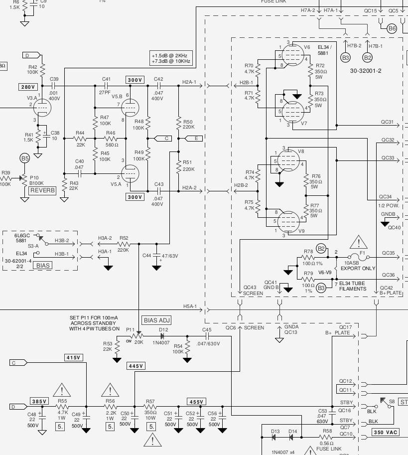

Progress but-
So the bias is now adjustable within the range I'm after. However, using two bias pots for 4 tubes leaves me with a rather large difference in settings for the pair of tubes in each channel. CH1 Va = 26 ma tube current at idle; CH1 Vb = 34 ma idle current.
Using my existing bias supply design I'll add the balance pot like the Fender design as illustrated below. Does anyone see a problem with this?
Thanks for the assistance,
Colorcat.

If you are concerned over all being alike, are you not buying matched sets of four to start with? Have you tested individual tubes so you can pair them with other tubes that more closely match them naturally? You might find the Ch2 tubes have similar mismatch but could pair with Ch1 to make two pairs of similar current.
You will note the Fender print shows the use of a center tapped pot, you have any of those?
But more fundamentally, you opened with the amp has been working as desired until recently. Why would we want to completely redesign the bias circuit now, when the old way worked until recently. Sounds more to me like something else in the amp failed. If the design were defective, the amp would always have sounded whatever bad way it sounds now. This is a guitar amp, not a precision NASA space probe.
