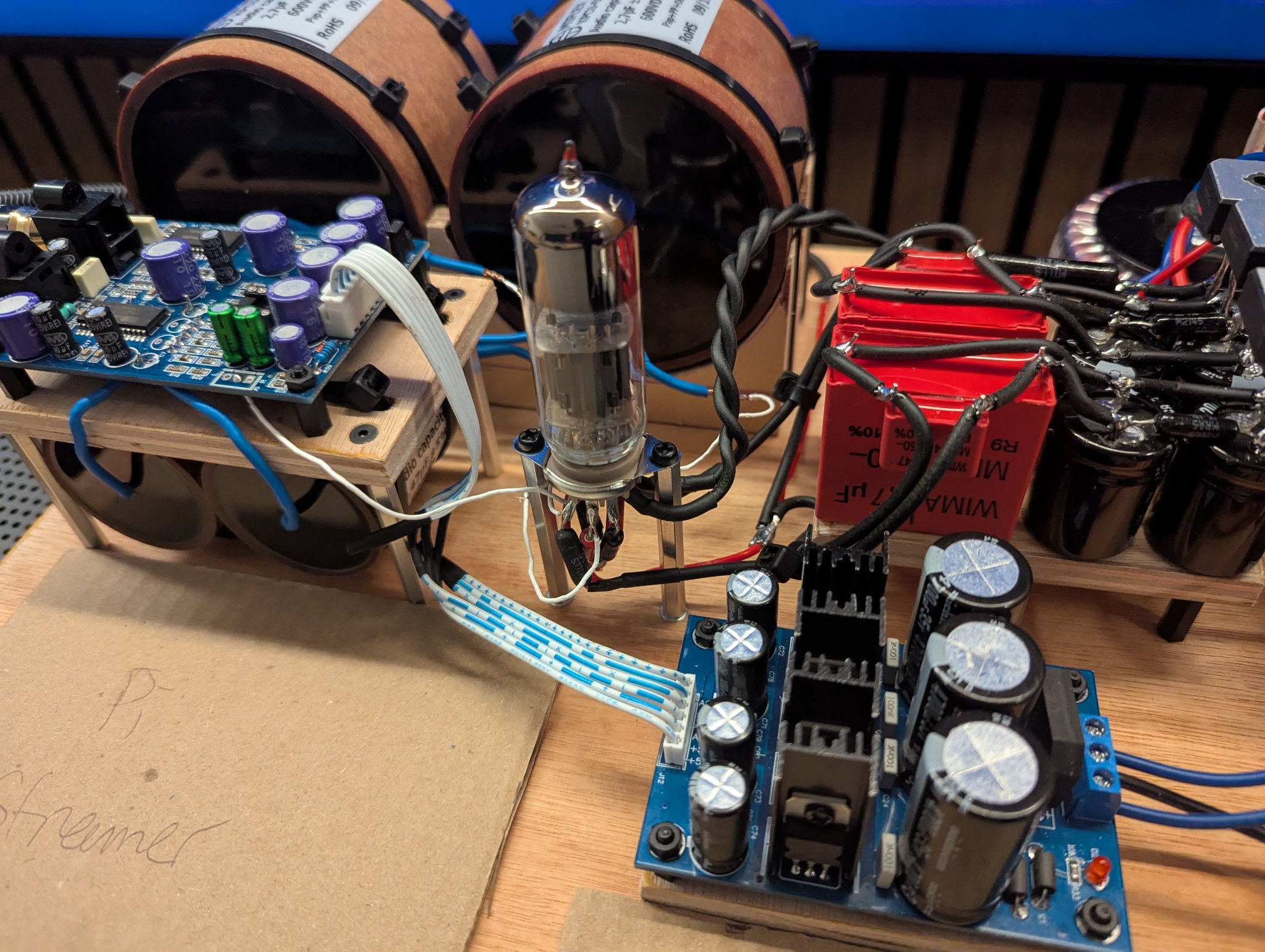

I just built my Lampucera, I'm finding the Right Channel is outputing 6.0v and the Left Channel is outputting 5.5v. This was measured at the RCA connectors whilst playing a constant 35hz tone into the pre-amp. This voltage difference is enough to throw the imaging to the right. Are there any tips on balancing left and right output voltages? Initial thoughts was to tweak the Anode or Cathode Resistors on one set of the triodes which might drop the amplification to balance it? or is it a case of 6N6P's are all different amplifications on each triode?
Picture for attention & thanks in advance

Do you have an oscilloscope?I'm finding the Right Channel is outputing 6.0v and the Left Channel is outputting 5.5v.
No Oscilloscope, just a Fluke Multi-meter, probing the signal (+) and ground (-) on the RCA connectors. And setting a consistent measuring baseline, I'm using a 35hz test track on Tidal, which I think is pretty close to peak output voltage. You reckon an oscilloscope is the way to go to troubleshoot this? if so, what's a reasonable one to go for?
You might be able to figure out what's going on by swapping parts around between channels. A scope would be best though. New digital scopes have gotten pretty low-cost, but used analog scopes on ebay may be cheaper. Also, if you don't have a signal generator, then a scope that includes one can be handy.

Kflex88, ive got a few of these boards (pre I2S SMD connections and same as yours) and have not experienced any issues.
May I suggest that you take some voltage reading directly from the DAC chip pins and post here?
Specifically:
1) between Analog GND (pin 21) and L- (pin 24), L+ (pin 23), R- (pin 19) and R+ (pin 20)
2) between L+ and L-
2) between R+ and R-

This afternoon I was able to try something I suspected, swapping in a spare tube I had. I had dropped one of the pairs on the wooden kitchen floor the other day, I was surprised it didn't crack to be honest, and I kept it and thought nothing of it.
But having now swapped in the spare I had, I'm happy to report the issue has gone away now. Using my rudimentary testing, I measured 6.4volts output on both RCA's now. Glad that's sorted because it was quite distracting!

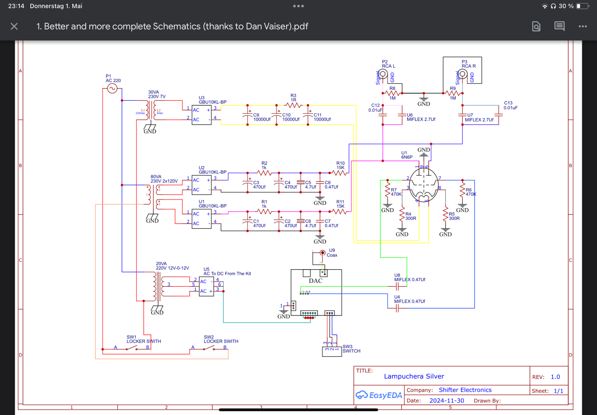

Hello,
I built the Lampucera in the iiWi version and I am very satisfied with the sound. Thanks for the many forum entries, they helped me a lot.
Since I switched the opamp to tube, I get a short noise, a beep or a crackling, that sounds at the beginning of a new track. This noise is only, when the new track has a different bitrate or sample rate than the previous one, otherwise it is silent. The sound is about in the middle and not just on one channel.
I changed the power supply of the anodes and of the heating, changed the capacitors in the signal path and changed the cable routing. no success.

Its because of the dropout that occurs when the dac and or the USB board switches clocks. If using a USB board, there should be a MUTE signal available that can be used to mute the dac analog outputs while the clock frequencies and or the sample rate are being switched over.This noise is only, when the new track has a different bitrate or sample rate than the previous one...

You didn't say if you are using a USB board for digital input to the dac (e.g I2SoverUSB or Amanero)? Finding the solution to your problem requires knowing more about your particular build.I just ask without great hope: “Does anybody know a solution?”
Also, can you post the output stage schematic?

Thanks for your willingness to help.
I don‘t use a USB board. My streamer is a bluesound node n130. I use it with optical spdif (the problem exists also with coax).
I put the schematic into the attachment, but I reduced the anode resistors from 15k to 1,5 k because I had to much gain with 15 k ( but also the noise problem). The input caps are russian pio 0,25 uf with silver mica 0,01 uf, the output caps are Russian pio 2 uf.
Differences are also in the heater psu (I used battery and alternative ac transformer). There was no difference with the problem, but the ac transformer made hum, so I will change the transformer with rectifier for dc).

No MUTE output signal on that one.My streamer is a bluesound node n130.
What TOSLINK receiver is on your dac? Do you have a schematic or a pic of that board or module?
What happens if unplug the optical TOSLINK cable while music is playing? Do you get a pop?
What happens when you plug it back in? Pop noise?
