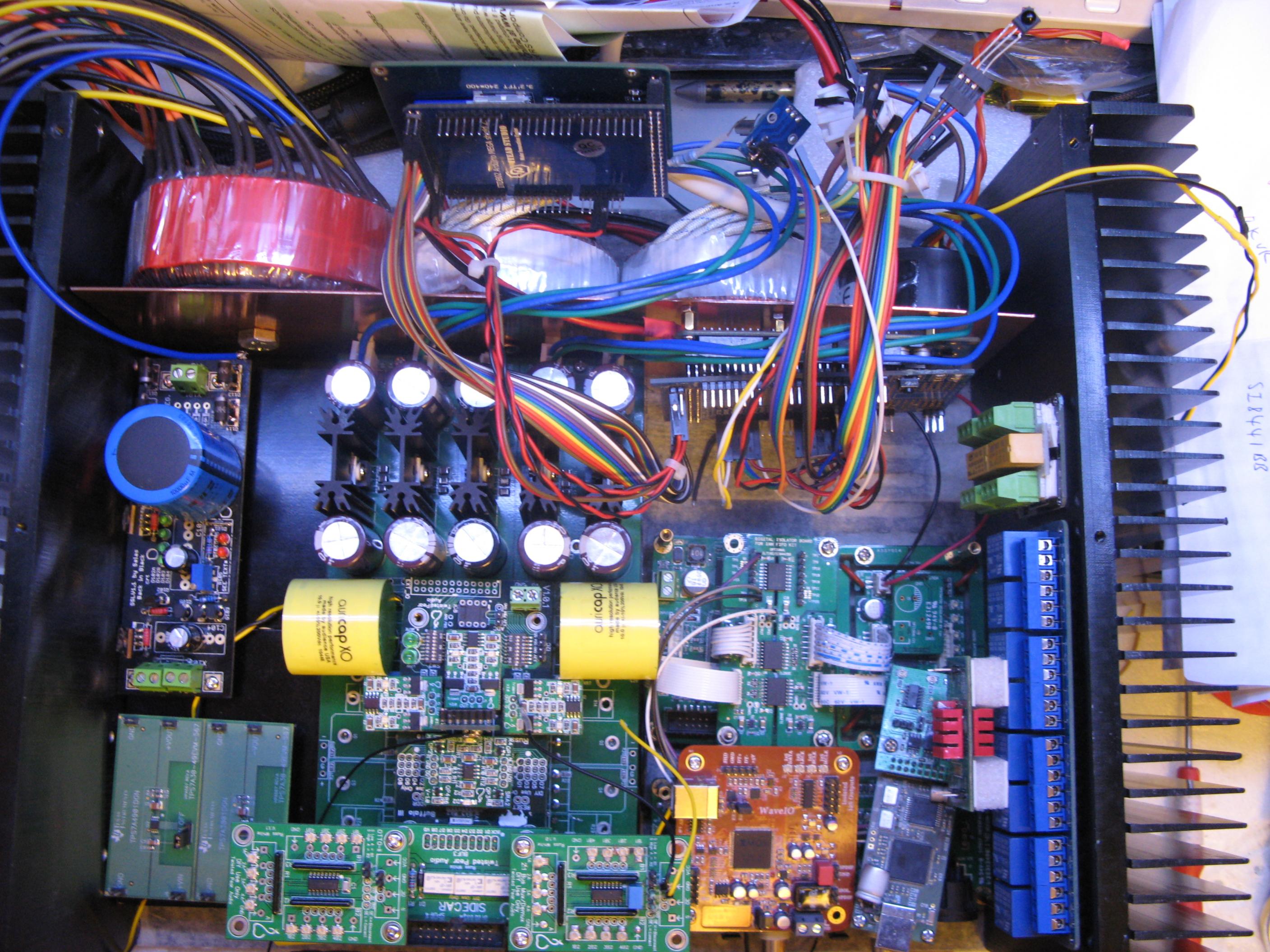

When I bought this power amp case for the DAC, I thought it should have plenty of space to accommodate everything, but when I have all the devices in hand, I find that I was wrong.🙁

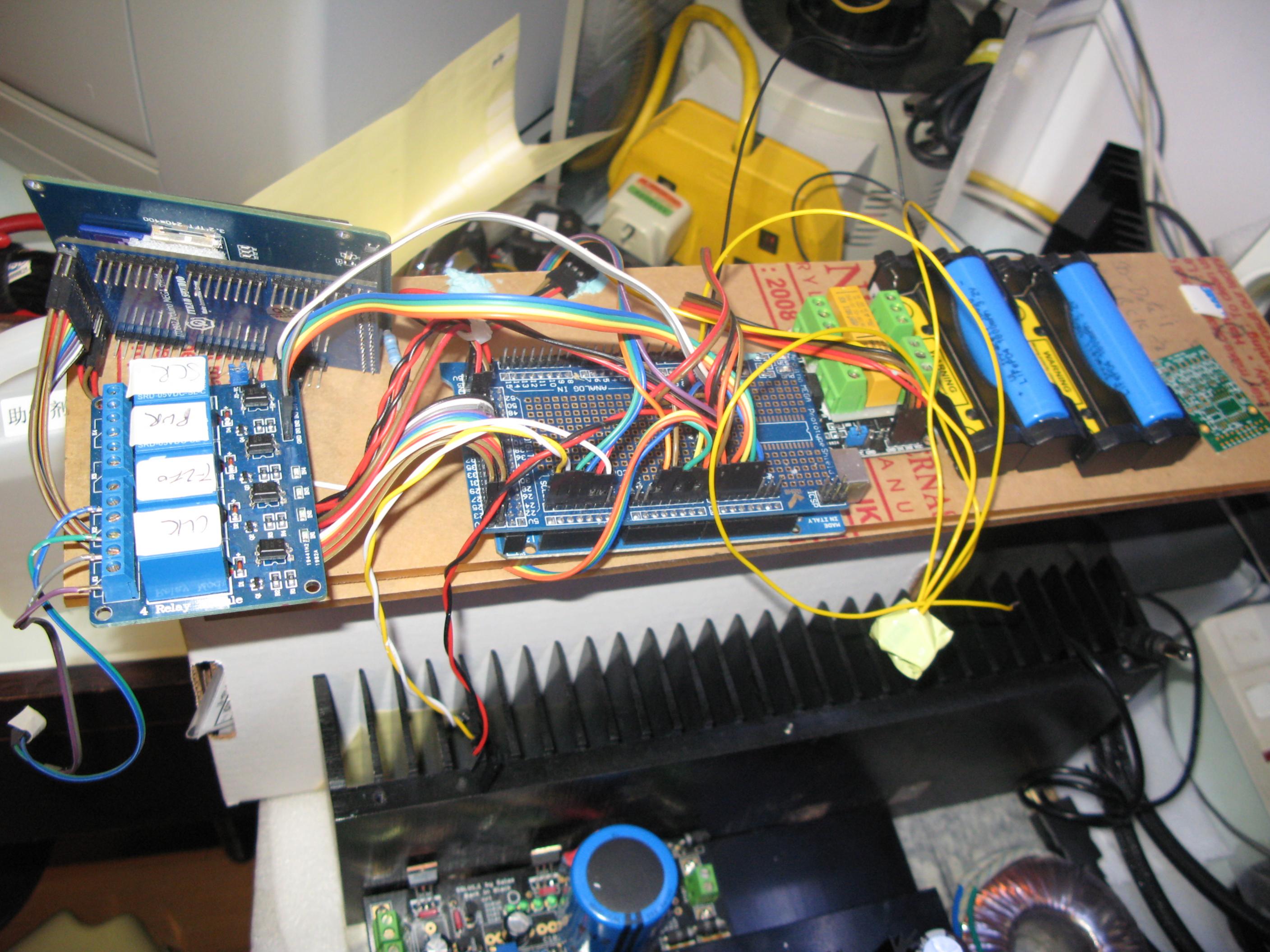

With the transformers, NTD1, SSLV, FIFO and BIII, there left no space for the Arduino, relay boards, battery, some more regulators ....😕
I haven't tested the 5V supply on the NTD1, I connected a 12Vac to the input and power it up. It has 4.99V output, but within one minute, the PCB near one of the diode burnt😱, found one diode shorted and another one broken. Other components seems fine. Have to repair the PCB and order some replacement diode and test again.
As the BIII will be powered by SSLV, I will modify the 5V supply on NTD1 to 10V for the Arduino, with a secondary regulator to power the 5V relay boards.
Still have a long way to finish this project.

Spent almost a month to figure out how to put all the devices into the case and finally, I believe it can be done. 🙂
Also spent two weeks to trouble shoot the NTD1 and thanks Owen helped me to discover a stupid mistake (again)😀
Drilling holes to fix all those PCBs is extremely time consuming. It is also difficult to ensure all holes are at the correct position. Except the USB input devices which will be mounted directly on the back panel, I should have mounted all other devices into the case and its time to connect them together.

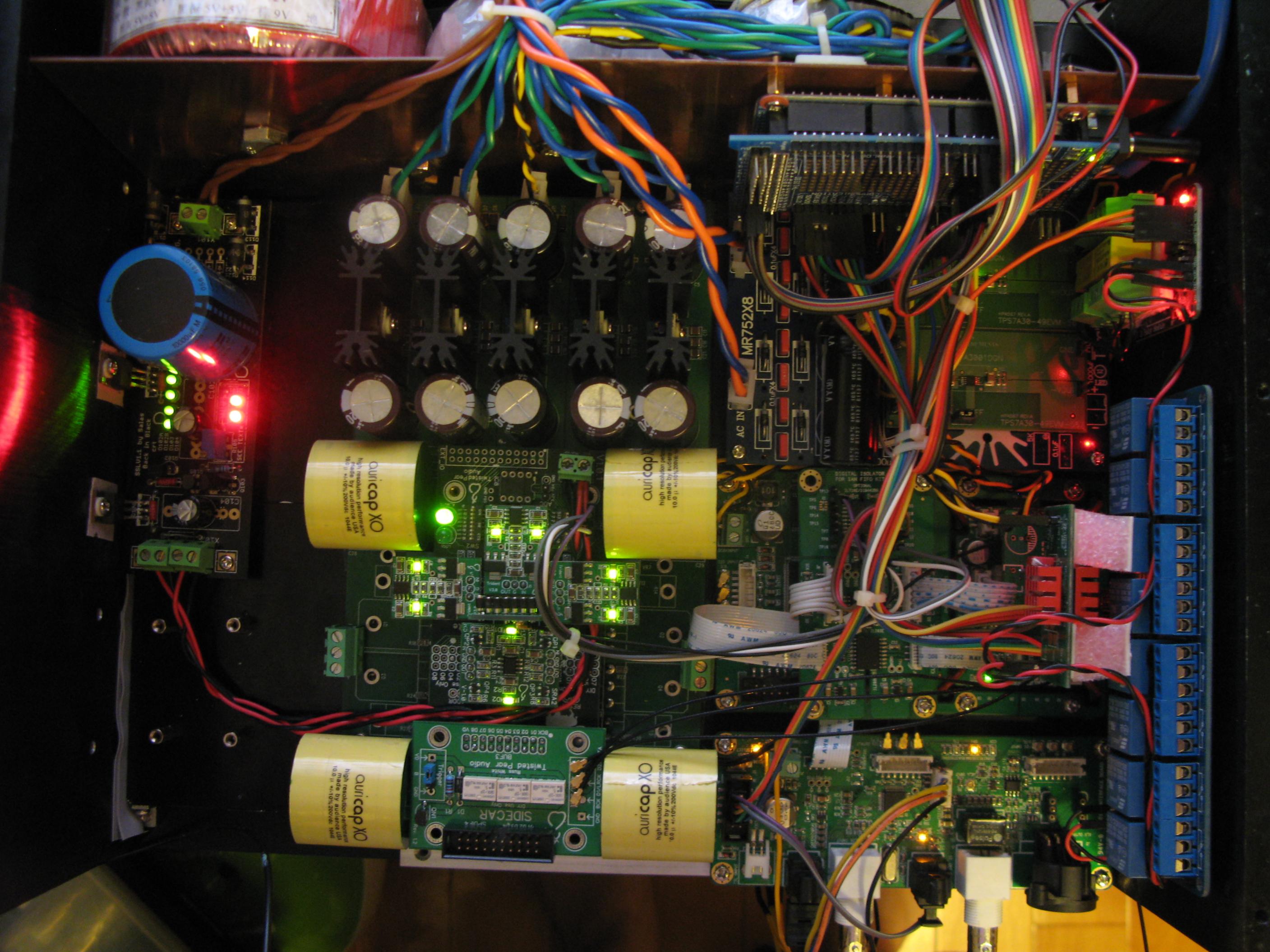

I tested all the PSUs and they are all working fine. Then Ian's FIFO + i570 + SPDIF also working properly. The Arduino and relay boards are also OK. It's time to mount the BIII onto the NTD1😀
Before mounting the BIII, I measure all the voltage on the NTD1 again. One of the Vs dropped to 0.3xxV, others are 1.5xxV. I thought the VR was adjusted accidentally, but when I turned the VR fully to both direction, the voltage only vary between -2.xxV to 0.8xxV😕
I really upset, something failed again. Power off it and measure the FET, found low resistance from G to GRD. If the FET fail, I have to replace all four FET with the spare set🙁
to check the FET, I have to desoldered it from the PCB, but remove the PCB from the heatsink is not easy. Putting it back after trouble shooting is a painful job.
Thanks Ian.
Spent an hour to remove the heaksink from the case and the PCB from the heaksink. Desoldered the FET and found it still alive😀 So it would be either the VR or the cap fail. Desoldered the VR and confirmed it's also fine. I thought ceramic cap is very reliable and would not fail. Measured the cap several times and confirmed that it's dead with a low resistant of 1xx ohms.
I don't have the same type of 10u cap, so replaced it with another 10u with higher voltage. Hope this wouldn't affect the sound.
Put the NTD1 back to the case, check everything again and connect all wires for control and signal. Power it up. No smoke😀
Fed signal to Optical in, BIII lock, mute LED off, so far so good. Still hasn't connect the audio output, need fine tune on the Arduino program and connect Arduino with i570, final will be the drawing for front panel express🙂
