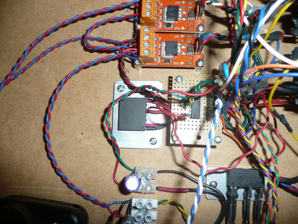

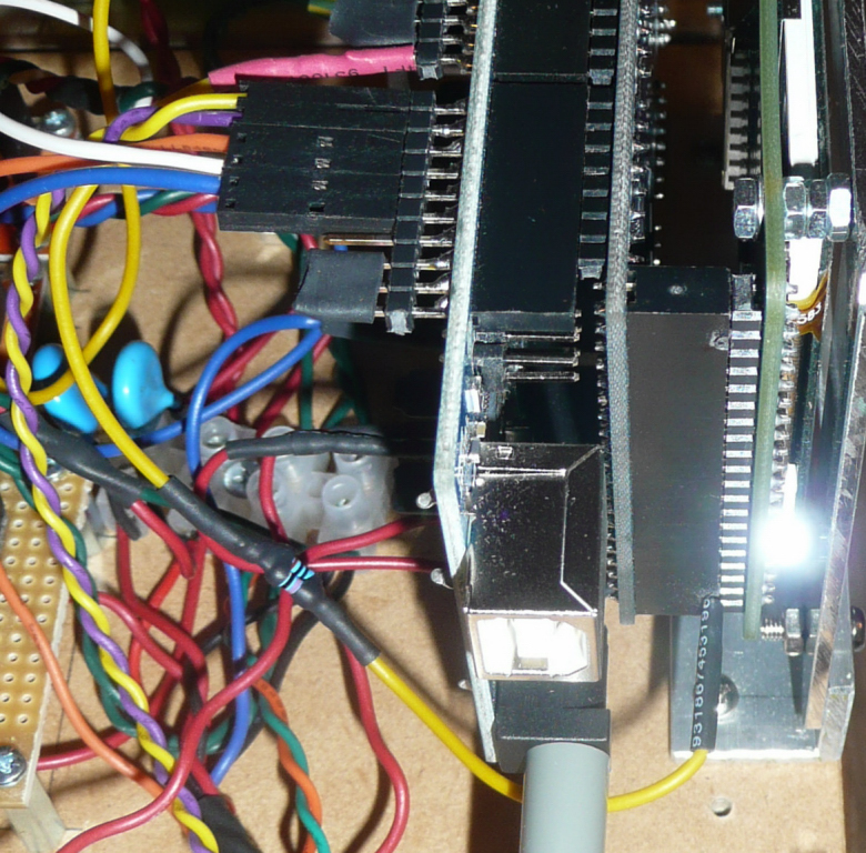

The backlight dimming has worked, the 3.3v & 5v connections from the Mega to the Shield are still in place, the 5v goes via a relay which switches when I turn the system on.
I have bent the LED pin on the screen at 90 degrees, cut a small slot in the shield 40 pin socket so the screen still plugs all the way in. I have then soldered on a lead to the LED added 2 resistors in series/parallel, to get 54 ohms, put a plug on the end of the lead & plugged it into the Mega 7 pin.
I have written the code so the backlight turn on at a defined brightness & can be adjusted with the left button on the Apple Ring, when I put it into sleep mode the backlight dims to defined value & turns back up if the sleep function is aborted. When the system is turned off the backlight is lowered to 0 volts.
BUT🙁, why is there always a but😕? For some mystical reason the addition of the backlight dimming is playing havoc with the remote reception. After much grief I finally go the remote working every time but now it is back to misbehaving, could it be something to do with the PWM voltage that is now in the system, any advice would be greatly appreciated.

Will try to isolate the LED pin from Arduino Shield during the weekend and advise you the result. I realize that you connect both 5V and 3.3V from Arduino to the shield, you should only connect either one. If you connect the 5V, then put the switch on the shield to 5V and the regulator on the shield will convert it to 3.3V for the LCD. If you connect both, then you still have 3.3V supply to the LCD even you disconnected the 5V.

Very nice!
I too had some problems with the remote when using analog write. I was not able to find the reason, so I gave up controlling the brightness with the Arduino and used a manual pot. It is possible, the pulsating LCD is creating a lot of noise and interfering with the IR sensor. I documented some issues here: Apple Remote Control for Buffalo II DAC H i F i D U I N O
BTW, what are those small orange boards?
Very nice!
Thanks, I'm glad it's not just me.
The orange boards are Tinkerkit Mosfet relays, they are switching the relays I had already installed into my amp & DAC.

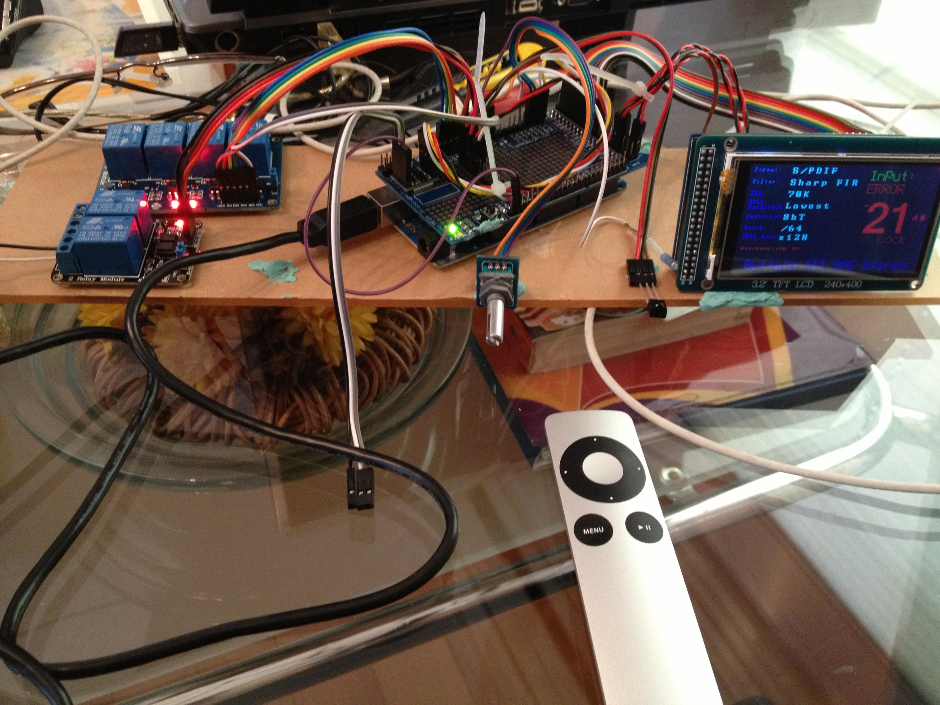

Removed the pin connecting LCD screen and Arduino Shield, solder a 47ohm resistor in series and connect to PWM pin. Screen dimming and off are working fine. Other functions including remote are working as expected. Number of relays increase from 2 to 6 and seems still not enough😕
