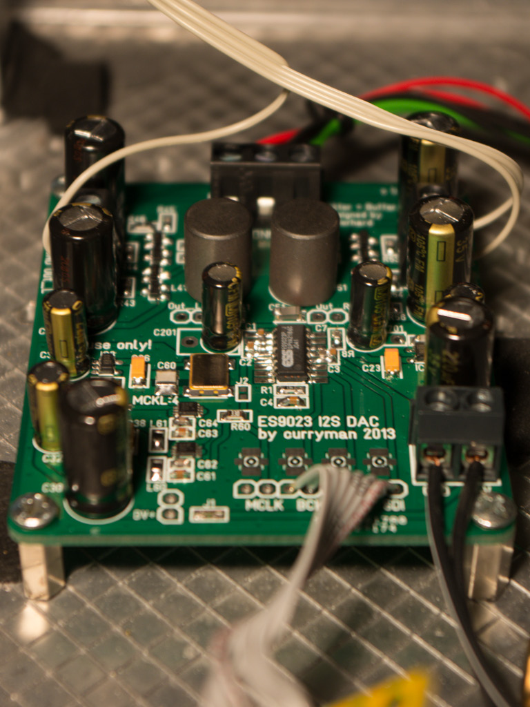

R8 and also R141 and R151 are indeed on the bottom side of the board, thus the mirrored names 😉. Now that I have received the boards I realized that my supplier puts silkscreen on both sides without extra charge 😱
R8 is underneath to gain some space for a filmcap as an alternative to the C701 Elcap (or Oscon,...).

New board up and running
I'm just listening to the new board and I am very pleased with the sound. Compared to the first Version I have the feeling of improved timing and clarity. But most of all I love the timbre - voices have great colour and cymbals sound clear and have body (mmh, I am really not the best at describing my impressions 😱).

Fantastic Daniel! Did the build go well? spacing? silk scenes? polarity?
Build went very well. The new pad layout for the ES9023 proved to be very convenient to add decoupling Cs very close to the IC. I used 10nF NPO + 2µF X7R (0603) directly at the IC for AVCC and NEG supply.
Silkscreen is correct this time 😉

There is a MCLK In/Out header on board that could be used to feed external circuits with onboard XO signal. Just place a suitable R at J2 position (0603 case).
Otherwise, I'd have to go with an external clock like Acko's new clock board and send that to the re-clocker which then would feed MCLK on the DAC board. Acko is calling this sync mode. I'm assuming I'd leave the XO off the DAC at this point.
Would be possible too. Just don't stuff the XO to the DAC board and close J2 to feed external MCLK to ES9023
What other parts would I leave off? Also what is the MCKL:4 used for? Is it for S/PDIF clocking?
If you don't use onboard XO you don't need the corresponding power supply (regs, Cs,...) of course. MCLK 1:4 is indeed intended for SPDIF or USB receiver, e.g. TENOR or WM8804 which need 12MHz clock (use 48MHz XO for ES9023 in this case). If you don't want to use the 1:4 option you don't need to stuff the flipflops and the corresponding power supply (regs, Cs, Ls,...)

To be honest I am not sure if (additional) reclocking helps in combination with the ES9023 (and also the other ESS DACs with internal "reclocking"), but I did my best to achieve a good board layout with respect to high speed digital signals. This includes the U.FL connectors as well as a (simulated) trace impedance close to 50 Ohm. Also the uninterrupted GND plane should help here.
I did not put too much thoughts into this reclocking nor did I test it but I would probably go the FIFO route. To me it makes more sense to "do it right" if you don't have any problems with the latency.

In case you want to send out the MCLK signal you should use a 0603 resistor (e.g. 33 ohm) instead of a jumper (0 ohm R) to "damp" the trace impedance.
The unnumbered pads are for alternative bypass Cs if you use LT1761 regs instead of MIC5205 (LT1761 connects BYP and OUT pin while MIC shunts BYP to GND). Next revision will have numbers also on the bottom layer 😉
