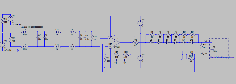

Passive filter output stage for ESS
Here's my first stab (just design and simmed in LTSpice, nothing built so far) for a passive filter output stage for this DAC. Not proprietary, anyone is free to use, copy, modify whatever 🙂
Key features - 4th order Butterworth response, HF linear opamp (no LTPs!). Caveats - its designed for great sound, the noise performance won't suit some as the LT6552 isn't a quiet chip. It is cheap though 😀

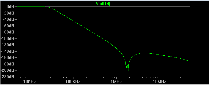

I had wondered about 2 x JG jfet filter buffer on balanced output of IV stage for 9018 but haven't got a 9018 DAC to test it on. Thoughts? Component matching for balanced will add cost but is a pretty simple circuit.
Just a thought, I might have missed something that disqualifies that circuit for the 9018 DAC. I'll be building one for se output of my ES9023 🙂
Its not a disqualifier, but the JG filter uses a much bigger inductor (18mH) which resonates around 500kHz due to the parasitic capacitance. Hence rejection at 1.5MHz won't be great. Whereas my circuit seems to have rather a nice notch around that frequency 😀
