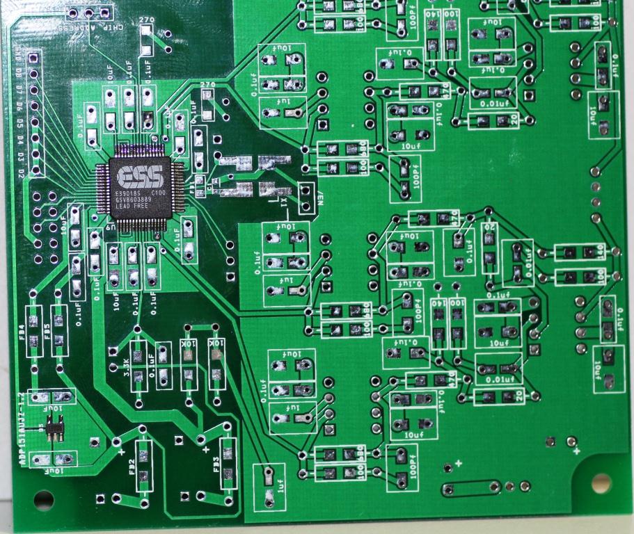

Misunderstanding guys - what I think - you can't separate the digital and analogue 1.2V from each other.... the routing division is under the IC.... so you'd need to desolder the IC, and then have a look. I have a friend who can do that but it's way beyond me. Everything else seems possible.
no thats how I understood you and its what it looked like to me from looking at the photos, thus why I asked you to confirm. forget removing the chip, even professional pick and place joints wont warranty that the chip will still work if you ask for removal.

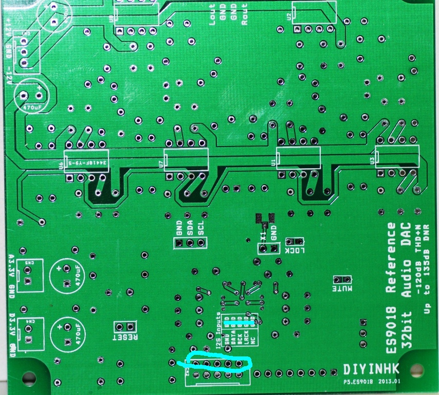

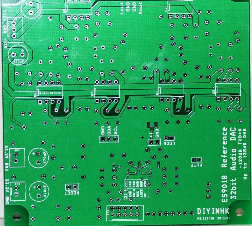

It looks like there is already a new version of the board. GLT's board has a date of 2012.12. The board I got today is dated 2013.01. There are minor wire trace changes and the addition of extra bypass capacitors. I will see if I can get a picture up later.
2013 January version. Es9018 board
Here are pictures of the front and back of he board I got today.
Have we gotten to where say his/their new ~$65USD Isolated I2s receiver board can mate directly with header pins?? No flying wires to the clocks and I2s?? As a daughter or piggy-back arrangement?
Is THIS the rumored 4-layer PCB?
A work in progress eh ? I can see there are now two positions for power supply caps for the op amps, which is more convenient, and the I2S can now be gsgsgsgs more easily so that'll be better for cabling/signal integrity.
