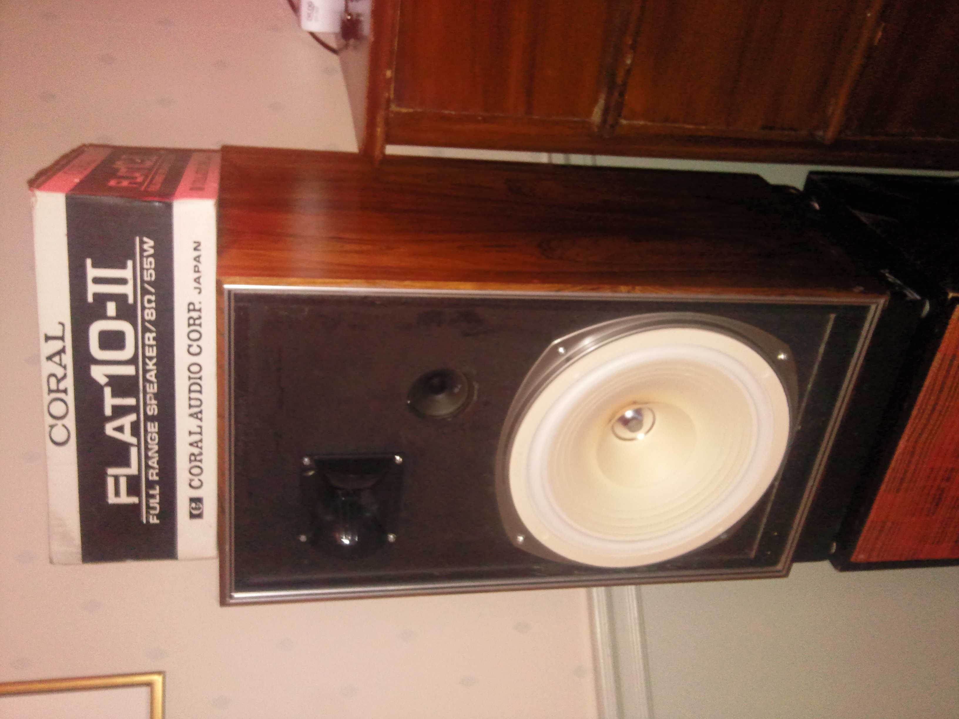

Here's a pic right now, the tweeter in the middle is not connected, just sits there from the old setup. Might be a good start for a reflex port try?
Also, how do i wire the speakers properly if I want to add a tweeter? I would still like the Coral to do full range wouldn't I? And just put a hiqhpass filter on the tweeter? What's the correct setup?

A larger cabinet would probably help. Still, for now, try the addition of a port in that hole. You might not like it, as the cabinet is likely too small to go ported (they need to be bigger, really...). I'd strongly recommend stuffing, though. It sorts out all sorts of internal reflections (they can come back through the cone), and makes the cabinet seem bigger to the driver, so the bass response will change, too.
Usually just a cap in series will do if it's a super-tweeter. I seem to remember 1uF is a good place to start.
So you'll have the tweeter in series with a capacitor, all in parallel with the Coral. Play around with capacitor values a little to find one you like.

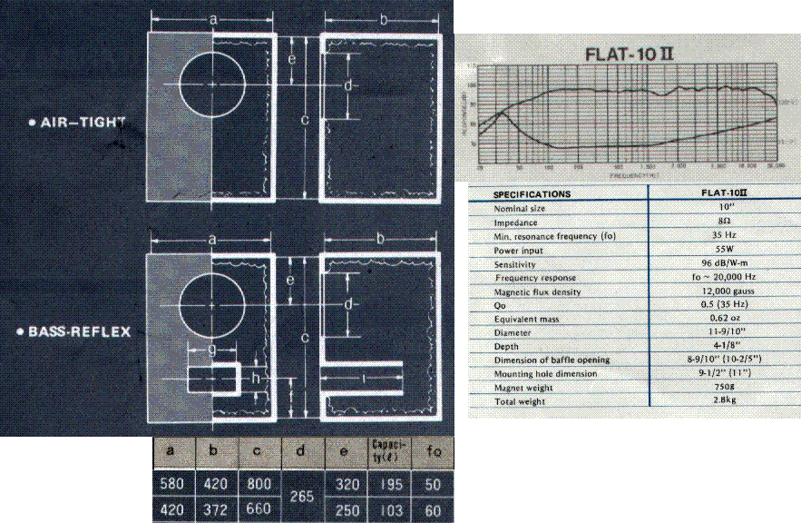

There's a lot of information on the CORAL's.
Pic from here
Singapore NoiSING 2005 DIY Audio Gathering Show Report
http://diyparadise.com/yabb/Attachments/Flat_10_bass_reflex_update.pdf
http://www.diyaudio.com/forums/full...-10-beta-look-alike-10-fullrange-drivers.html
http://www.diyaudio.com/forums/full-range/83984-coral-flat-10-a.html
http://new-hifi-classic.de/forum/index.php?topic=756.0
You can decide from now, if using it as a mid or not, in your studio. If, in the future you use a woofer or sub you probably can use it in the box you have now, closed enclosure. If building it for under 100Hz, then build one of the new cabinets. Having in mind that the sound will be more detailed if using it above the "moving cone" (LF) frequencies. It seems the PLANAR/RIBBON/AMT is a good choice for tweeter, but as is the soft dome, maybe a pro one because of the 96dB of the driver. Tweeter or not. People say the Beta has a longer extension on the HF, and the Coral Flat-10 not so much. Very nice project ahead...
