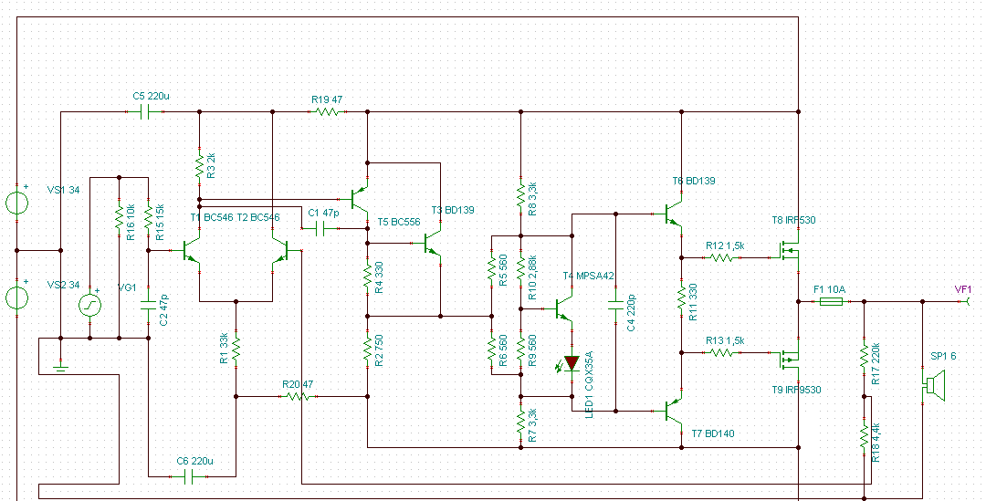

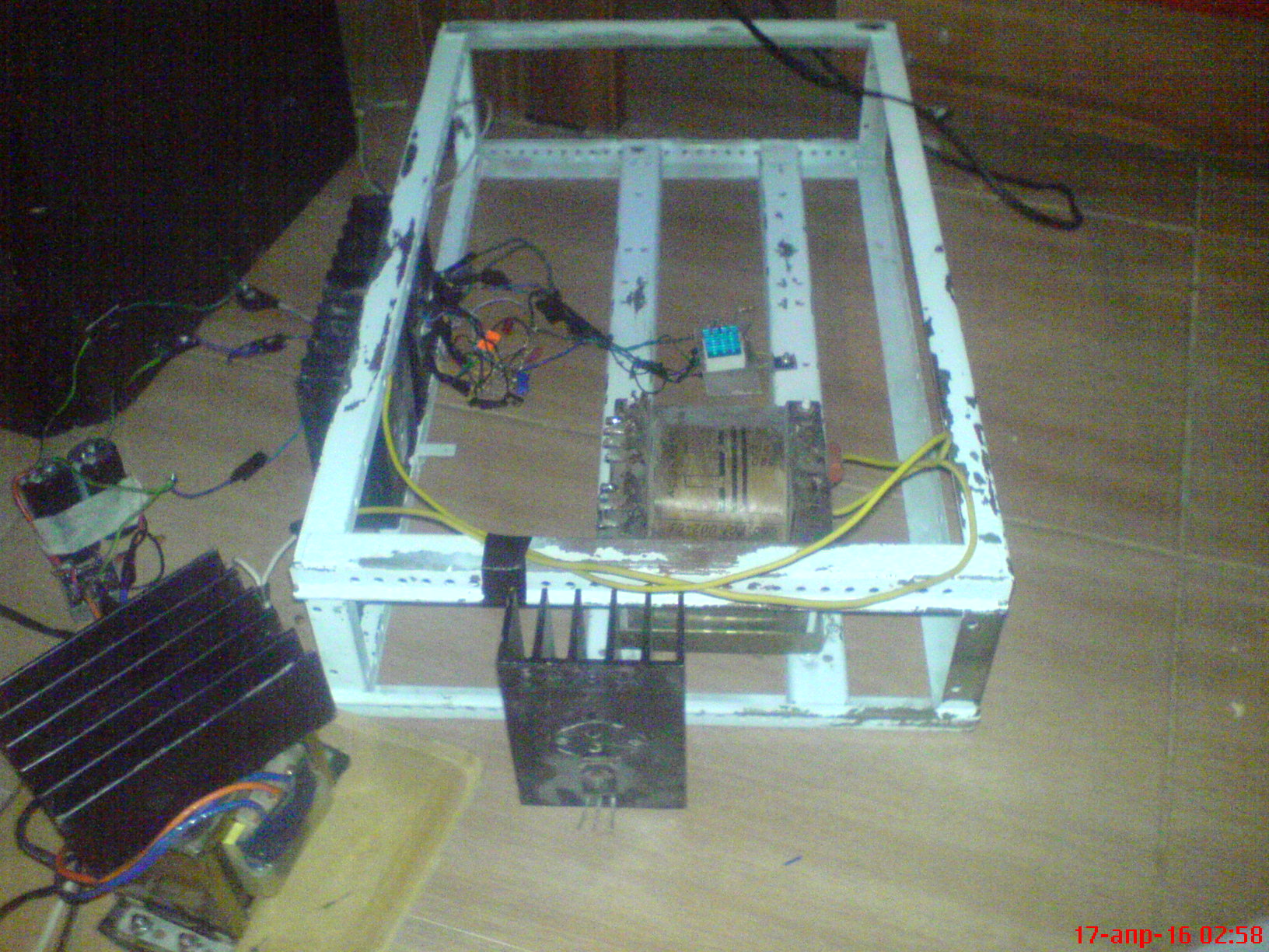

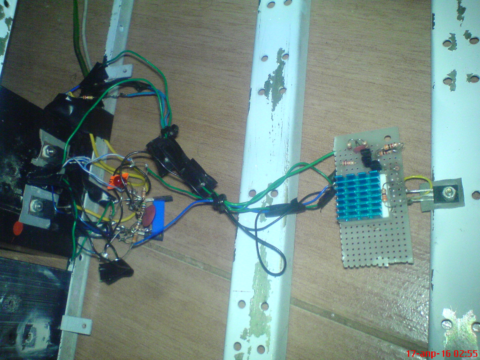

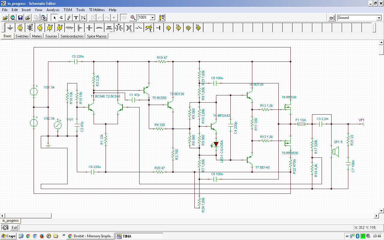

try this sounds very good 🙂
but there are not any protections
R2 must be 5W and T3 must be on a small heatsink.
T6 and T7 need no heatsink but its good to mount them to one ;p
R10 must be one 560 and one 5k trim pot in series for tuning standby current.
this offers class A input stage + class AB output ;p

I'd replace R9, R10 and/or R11 with a pot, so I could adjust the bias of the output stage. Different FETs of the same part number might need a different bias voltage. FETs usually run a higher quiescent current than bipolars, but you want to get that right. When a solid state power amp blows up, it can also blow out the speakers. If you're really new at building amplifiers I might recommend instead a LM3886 class AB chip amp. I built one of those and I'm gettin 50watts rms into 8 ohms and it sounds great. There are 3886 kits on the web that you can buy.
Bob Richards' suggestion is good.
IF you want to build discrete, choose a properly designed and tested circuit, not the half baked untested one on post #2

your comments doesnt make sense since i already mentioned that.

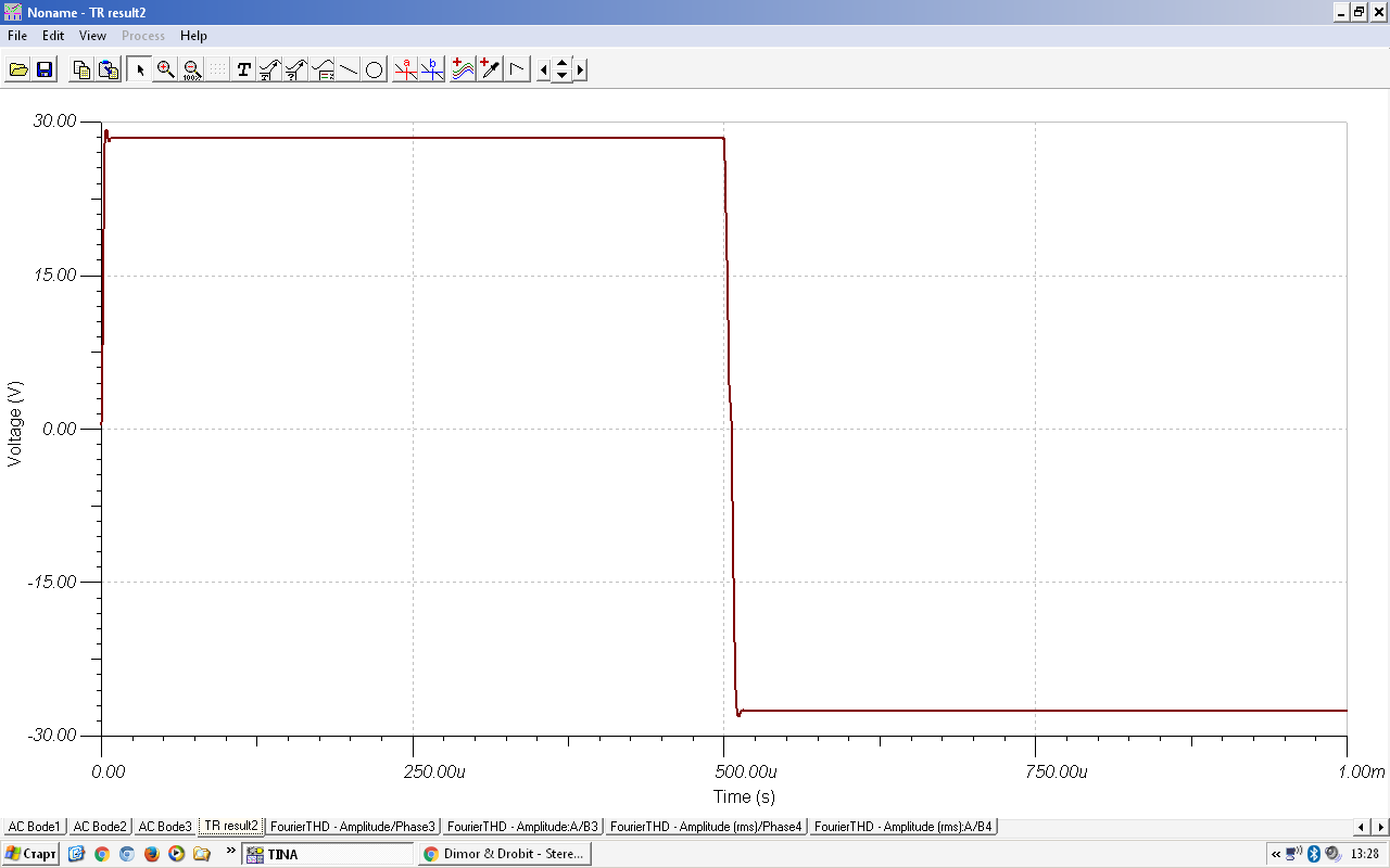

its tested, the only problem is the limited output voltage by the output stage.
i will fix that with dynamic changing resistances -> bootstrapping. just need to think about it.
Even limited its enough high ;p
here is the proof its triple tested ->
http://www.diyaudio.com/forums/solid-state/290004-irf530-9530-amplifier-simulated-multisim-tina.html
in three simulation programs -> multisim, tina and reality

Try it at full power at 20kHz into a dummy load. That's a test, not 3W into recycled PC speakers.
And 'tripple tested' because it's 'tested' in 3 different simulators? If you knew anything about simulators, you would know all of these use the same basic simulation engine and given the same models will give the exact same results. Neither of which are real world because a simulator and a model is not the real world. Amplifiers are tested in the real world and with real world instruments.
Stop trolling and start learning, and stop accusing anyone who critiques your half-designs of 'not making sense' especially people who have ben designing amplifiers longer than you have been alive, because as it is you just come off as an idiot. And moderators, feel free to censor me, but I'd bet you most here don't think I'm not telling the truth.
And to the original poster:
Ignore this guy's posts. Or don't - if you feel like beta-testing someone else's guesswork designs.

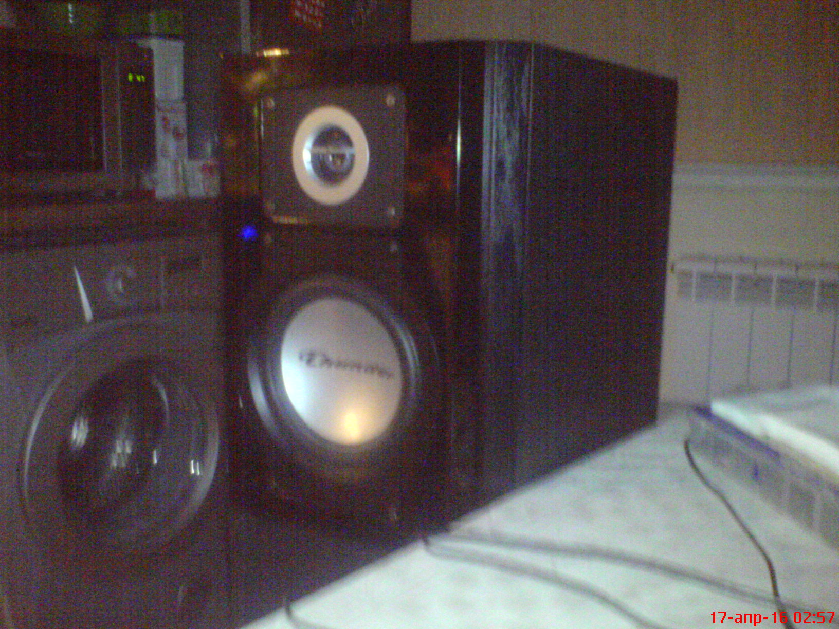

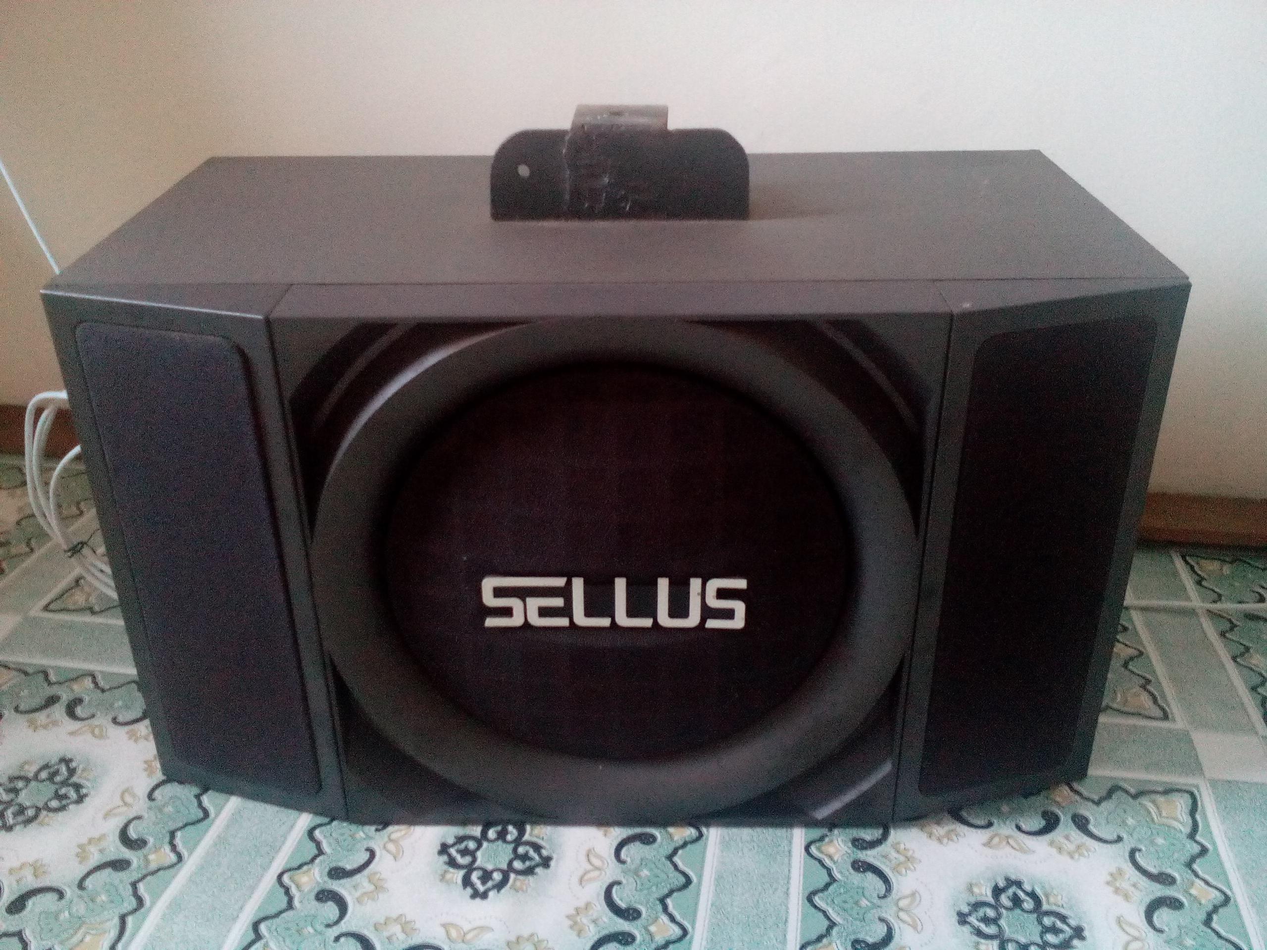

my speaker branch sellus (hyundai) its use for karaoke. not standing speaker. he4 my old amplifier pioner v210. sorry my english it not good.
Not standing speaker = compact = good/better than a standing,-)
Do you have a photo?
i' ll upload the photo. its 350 watt 8 ohm. 10 inch. i used too pair with amplifier mixing pioner v210.

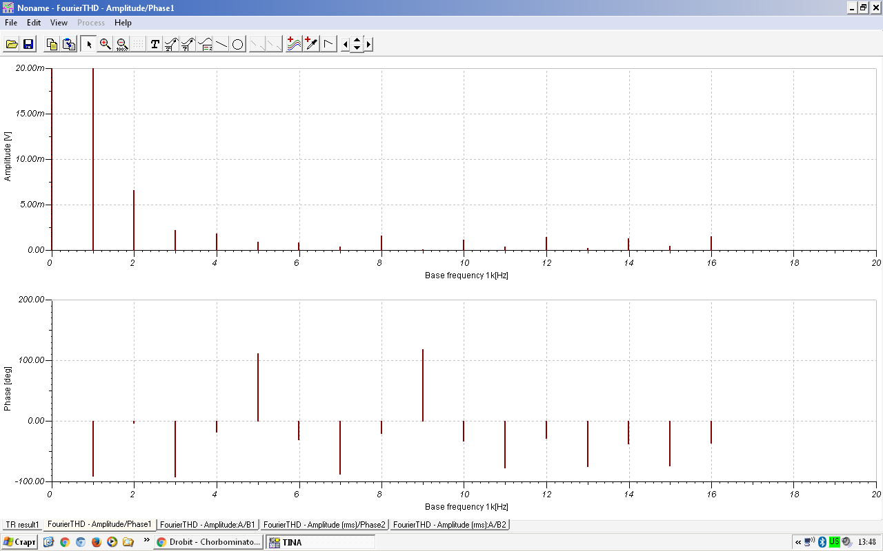

The 3rd simulator as i mentioned is REALITY and IM SURE YOU ALREADY READT THIS !
Tried with good speaker at very good power and its surprising clean good and simple amp better than complex ones ! I learned what i needed, nothing more to learn, more is more than more and its dangerous /!\
This is not crappy PC speaker. This is big powerful speaker ->150W 6ohm 90db 40Hz-20kHz. with two basses, big middle and highs.
They use same engine but they're using different data.
for example offset in multisim is -108mV where in TINA is 37mV.
They are not reality but they're reality too 😉

I really doubt that 10" speaker can take 350W.
It may have a 1.5", or 2", voice coil rated for 50W to 100W and may take music program upto 200W as short term transients.
you can browse amplifier Pioneer v210. i used to use my speaker withbthis amplifier. as i know this amplifier have very high power.
