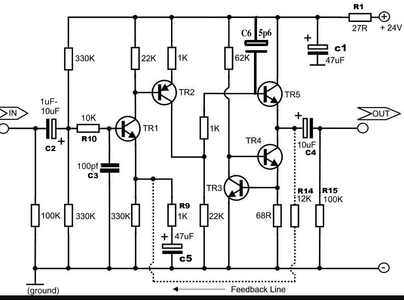

This is all the Ebay NAC42.5 clone contains on a single board. It has a single input with no switch selection but includes the regulated power supply and a volume control. The control is not shown on this old kit version schematic, but it connects to the input, shown as connector XX1).
As a preamplifier, it's really just NA321 with volume control and is designed to be cheap, so the performance is not likely to be very good because of the circuits being closely packed together with the PSU. There will likely be further low level noise and cross-talk due to non-ideal PCB layout and whatever DIY wiring technique is used.

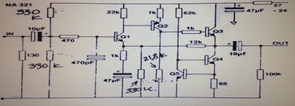

NAC42.5,
Make http://www.acoustica.org.uk/ "Recent Gain board" changes and add input filter before pot. I used 4k7&100pf (350khz) only. Pre's HF becames more clear (big change exactly). Now: filters freq. on pre, 350khz&150khz (2k2&470pf (I have good cup for 470pf, Naim's adviced 10k&100p)). On nap140 102khz(4k7&330pf). all cups are polyester or MKS2 or 1kvolt. Naim used 70khz filters, I couldn't test all freq filters 🙂 ref (https://www.hifiaf.com/nait2-recap-guide/):
Note that C5 (or c12 on the schematic) on pre is very important cap. It must be very good kind. I used Elna silmic II.​
