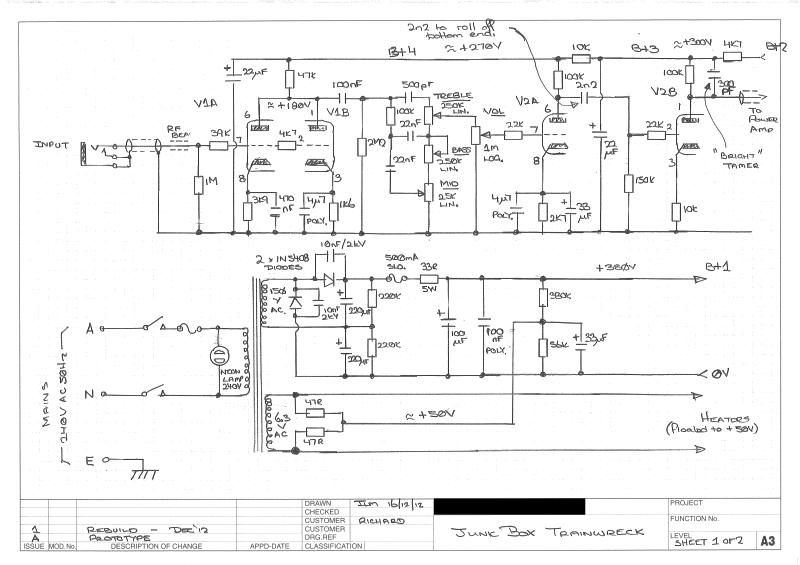

For your possible interest here is a "Junkbox Trainwreck" I built out of an old Philips PA Amp where the B+ was 380V. It is drop dead gorgeous. You could easily sub 6L6 into this circuit. The Power amp schematic is pretty "generic" and could be used as is with 6L6 and your existing output tranny. The preamp is the classic Trainwreck Express with a parallel input tube modification of my own design. It takes pedals fairly well. The chassis has enough tube sockets to do a really High Gain preamp if you wanted but if this is to be your firsst build I would probably advise against it, the more complicated the circuit you select then the more things that can go wrong and the harder it maybe to set to work.
