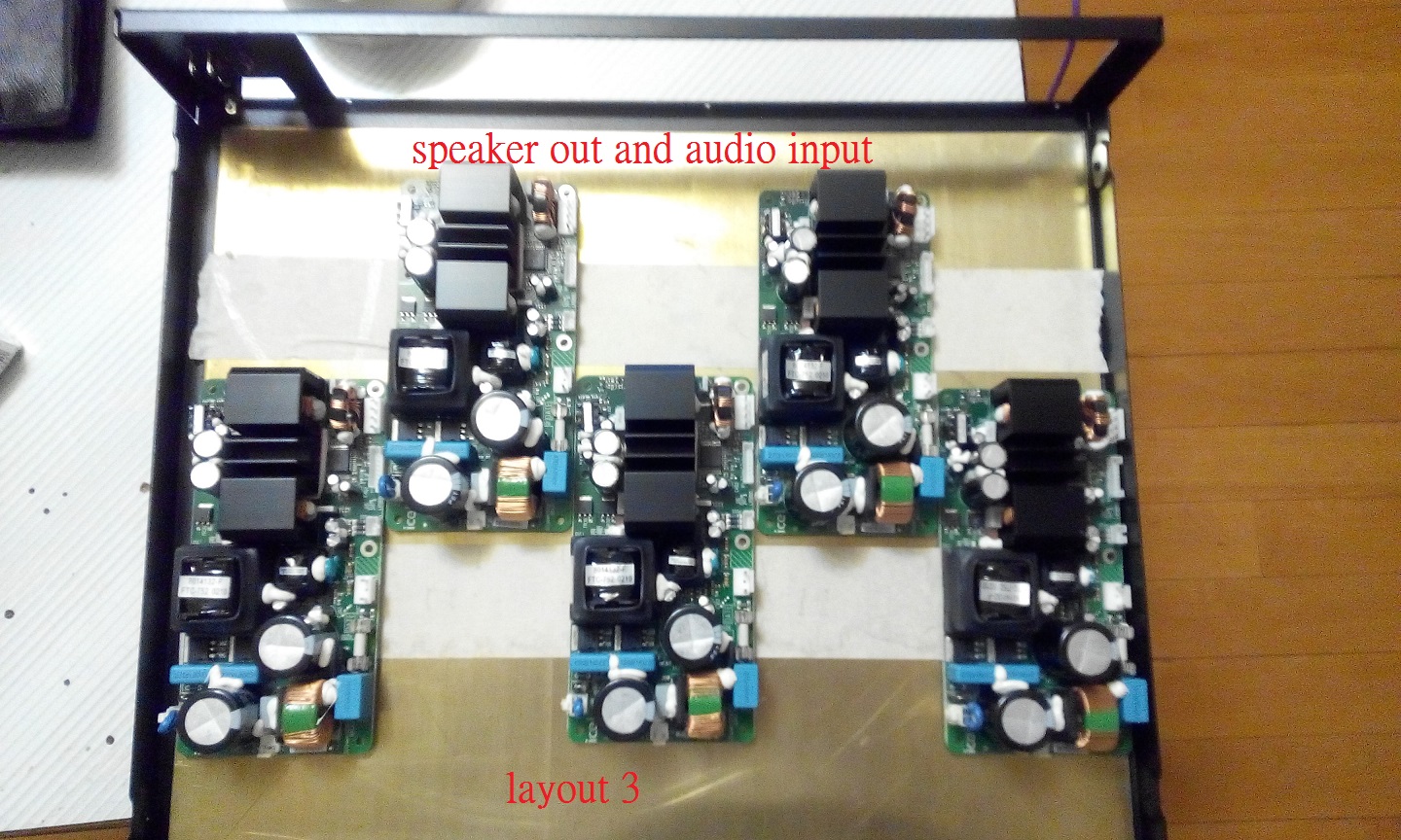

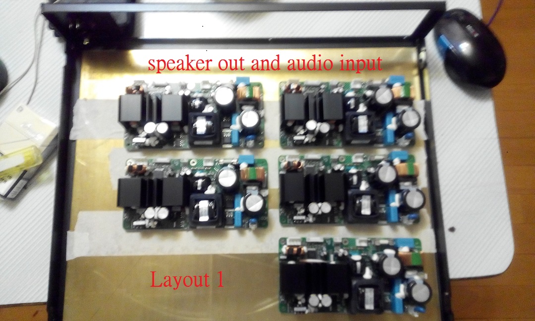

I have got 5pcs ICEpower to AV power amp
need advise which layout is best or any best than
In general I would prefer independent power supplies for each channel resp. for each module. So you can better handling the GND management.
For your application this means an outdoor power supply.
Additional I would use for each module an own screened (e. g. aluminium) enclosure to avoid inteferences between the mudules in the kind of this one:
1590B | 1590 Aluminium Enclosure, IP54, 111.5 x 59.5 x 27mm | Hammond
Check out post #2 under
http://www.diyaudio.com/forums/clas...ic-about-rev-engin-not-complete-finished.html
Maybe your modules are similar and the schematic is helpful for you.
