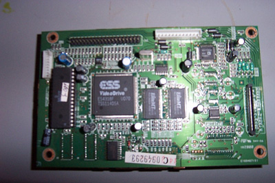

How about taking the mainboard with the upgraded eprom installed and sticking it into a nice solid chassis. Upgrade the hell out of the psu or build a new one. Integrate the Apex display, rf receive, and front panel buttons. Install a quality cd rom drive and a removable hard drive(slide out) that you can jockey to and from your PC.
What are the options for good sound quality? Can the spdif off of the Apex board be reclocked ? If so, you could do mp3's on cd's as well as a zillion mp3's on a dvd if you put a dvd rom in there...just for the convenience. Or would better results be had by messing with the spdif on the optical drive itself..forfeiting the hard drive? I am for improving the Apex spdif out..so you can have the hard drive audio. The main board and psu are littered with ultra cheap caps etc.
Anyway, it seems like a pretty quick and easy way of getting a home built, super flexible, CD/hard drive player going! I just don't know how to make it sound good.
attached is a pic of a AD500w mainboard...

I bought a so called Hiteker, same as APEX, several years ago.
Reason for buying are the 5.1 analog outputs.
And also i have been wondering about changing the analog output stage to improve it. Of what i have seen , they stuck PCM1702 or PCM1704's in there. These are not the best and also not the worst DA converters.
Starting with a new supply and decoupling it at the IC's directly would dramtically improve the sound , i think.
Since the PCM's need I2S input, you'd better start reclocking at the input and stick a better opamp in !
grtz
Simon

I have an Apex AD-500B (which uses a different ESS-based digital board from the plain AD-500 or 500w). I upgraded the firmware long ago for region-free operation, which required physical removal of the EPROM and the use of an external EPROM programmer.
This unit is easy to modify for several reasons:
1) The PSU layout is spacious, with plenty of space between components on the secondary side. This allowed easy upgrades of the secondary electrolytic capacitors on the +5v, +12v and -24v rails - I used Nichicon HD and PW, but any low-ESR, long-life series should work fine.
2) The transport unit is a stock computer IDE (PATA) DVD drive - it can easily be replaced inexpensively, even with a CD-ROM drive if DVD playback is no longer required. This allows DVD-R and DVD-RW media-compatibility to be improved, if required.
3) The digital decoder supports decoding MP3 files written in ISO9660 format to CD-R/RW, in addition to stock CD audio. The layout of the digital board is convenient, with the DAC located at the corner, very close to the power connectors as well as the analog audio-out connector. The audio signal path length to the connector is less than a centimetre, and includes a 10uF DC-blocking cap for each channel. I replaced both these caps with Nichicon Muse SW-series caps.
4) The rest of the analog signal path is on a separate analog output board, which contains the op-amps, back-panel connectors, etc. This board is single-sided and very easy to work on. I upgraded all the electrolytics in the signal path to Nichicon Muse, and bypass caps to Panasonic HFQ and Nichicon PW. A ceramic 10 nF bypass cap next to the op-amp was replaced with a 100 nF polyester film cap.
5) There is a single op-amp for each channel on the analog board, and this is an NE5532. The supply to the op-amp is a heavily filtered, single-rail +12v from which a +6v center reference is derived. At the moment, it sounds fine with just the capacitor upgrades, but future upgrades could include an LM4562 or similar ultra-low-distortion op-amp to replace the NE5532. There are also a few small ceramics left in the filter sections of the audio signal path, which need to be upgraded to styroflex/silver mica.
In short: Although long discontinued, this is an inexpensive unit with an excellent, short, simple and easily-modified audio signal path. The digital decoder handles a variety of audio formats. It is a worthy alternative to more expensive CD-only transports like the Marantz CD63SE and similar.
