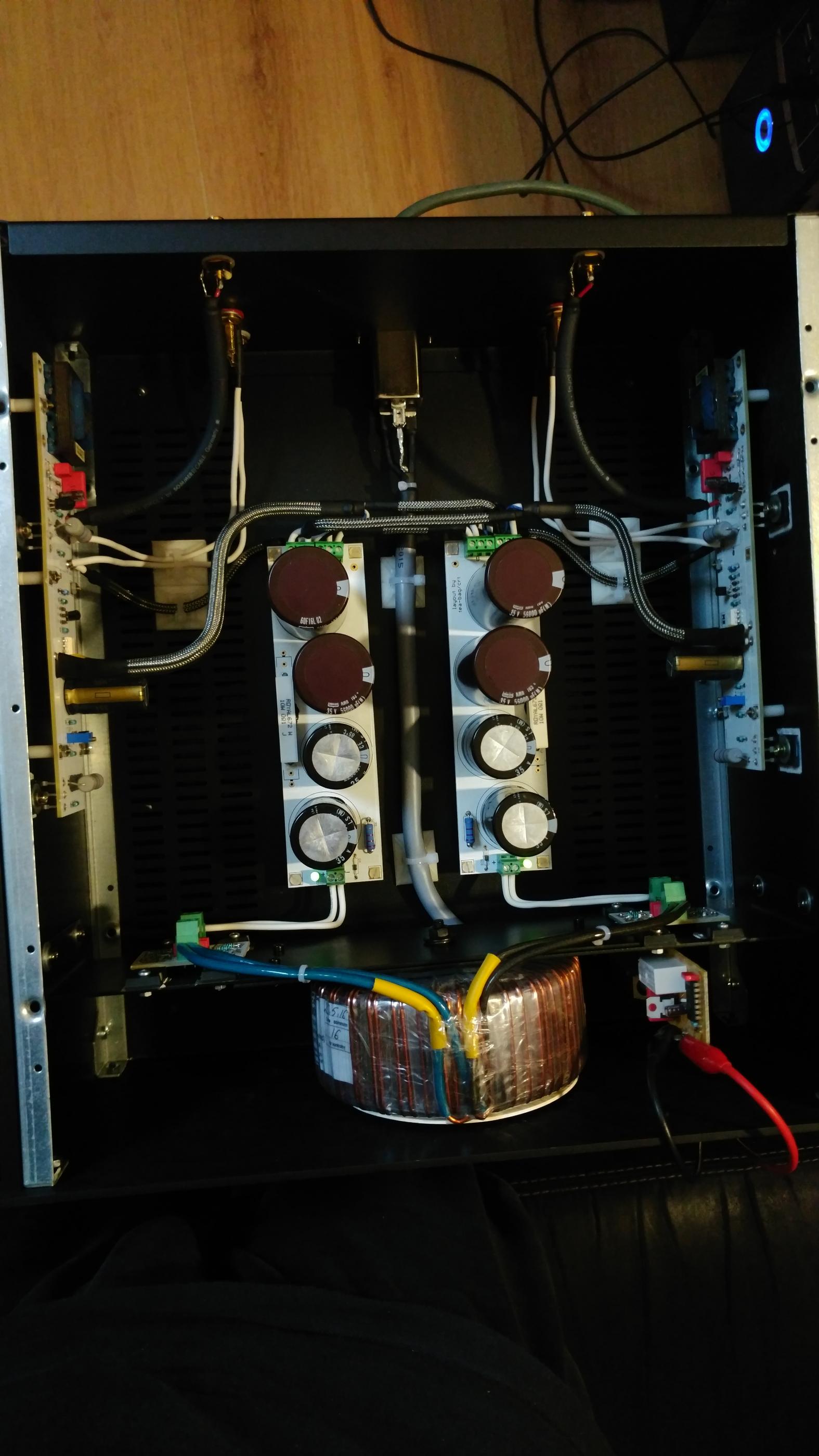

Build amplifier
All you need is here: http://www.firstwatt.com/pdf/art_f5_turbo.pdf
...and here: F5 Turbo Builders Thread
There are also other threads on the F5T V3 that you can search for.
Boards are here in DIYAudio Store: F-5T – diyAudio Store
Do lots of reading, then read it again and maybe again. It's a lot of reading but you will be rewarded if you put in the effort, I promise. You'll understand why everyone says this afterwards. FYI: it produces some serious heat! (about 500w for a pair of mono blocks :flame::flame::flame:) If you decide to go with the store chassis then you'll need two of the 5U chassis (one per channel). It's not too hard to build and there's lots of info on it to help get you to audio nirvana...and you will, if you put in the effort. 🙂
The store is out of matched JFETS at the moment but there are other outlets for genuine parts. Maybe others can chime in on that.
TJ
Thank you for your answer, I will consult all documents. I have already bought in anticipation the pairs of Jfets on ebay to the member
punkydawgs recommended by Nelson Pass ... The heat is really not a problem for me, on the other hand I see that the bias is only a 1A seems not huge for the class A 100w. I have already built a lot of amp in class A of the French electronic journal Led which was specialized in audio and the bias was set much higher (between 1.5A and 1.8A) that but against did not put the but on the radiators so much that they were hot ....
With power supply rails at about +- 45-46v. Bias is set at .7A/pair. 2.8A total bias. That's right around 100watts of class A into 8 ohms. It will change to AB over that, until it runs out of steam.
Don't worry, it will be hot. Mine at the above settings, in a DIY Store 5U case, runs between 48 - 54c (depending on ambient).
BTW the BA3 as a preamp works really good with F5T. 🙂
Thank you for your answer, yes now it's clearer for me, I understand better. I order everything to make the V3. Thank you to all those who responded
