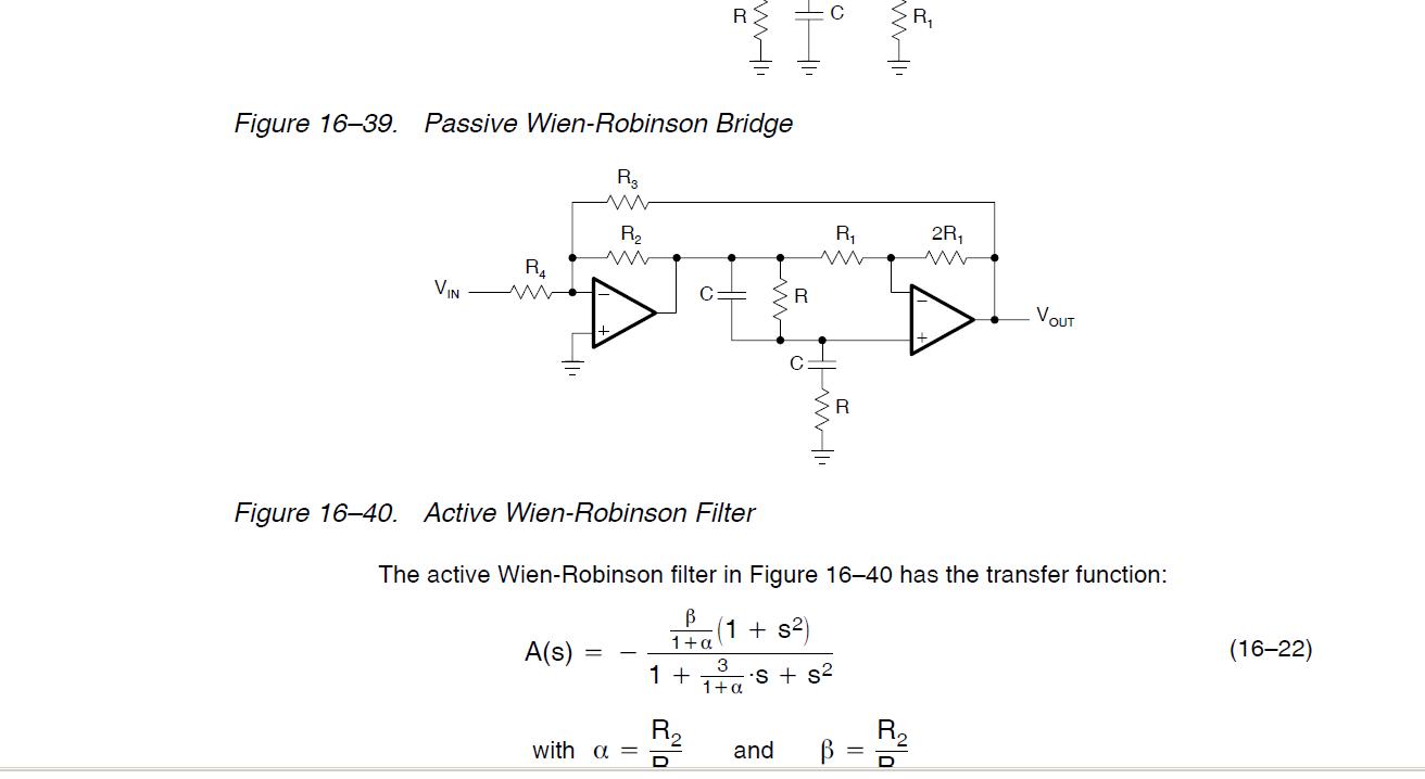

I quickly made an LTspice sim of the Wien-Robinson notch filter; I'd never heard of this filter until today, when a I got a book called "Circuit Design: Know it all," from Newnes Press. Turns out the circuit is very similar to one I designed myself when i was trying to get the HP334 to work better. Sadly, this circuit, like nearly any for a Wien notch filter, still has a diff amp for the post-filter amp, so common-mode issues will be there....
Here are the design steps for this filter (I chose the circuit values to be in the mid-range of impedances, but the tuning Rs (R6, 7) and Cs (C1, 2) are roughly those found in the 334 at 1kHz):
1. Pick f, R, and C for tuning using f=1/2Pi*RC.
2. Pick a filter Q -- I ended up with a Q of 3, which gives a 2nd H. attenuation of about 0.25dB.
3. Pick a throughput gain, A -- I chose unity. The 334 filter system attenuates by a factor of 3, which is not good from a s/n point of view, so unity gain should improve that by about 10dB, but will mess up the output scale on the front. To keep things as they are in the 334, a gain of -10dB (0.3162) could be used, but I haven't looked at what that does to parts values....
4. Calculate alpha = 3Q–1
5. Calculate Beta = A*3Q
6. Define R2
7. Calculate R1 = R2/Beta
8. Calculate R3 = R2/alpha
The 334's auto-tune adjusts R6 and R7 to tune for phase, so that should still work OK in a 334 mod. Varying either R4 or R5 adjusts the amplitude balance, and the stock system also should be usable in a 334 mod, though auto-tune signal polarity will need to be checked.

Hi Dick,
The differential voltage at the input of U2 is about 20uVpp with a 1Vpp input to the filter. This shouldn't present a common mode problem.
RE my post #138 in this thread -- I made the mistake of reversing the inputs of U1 -- Thanks David for catching that.
Here are the correct .asc and .jpg files for the Wien-Robinson notch filter. The values in this schematic yield Q = 3, which results in about 0.19dB of 2nd H. attenuation -- a Q of 2.5 gives about 0.32dB attenuation. Sorry for the error.
I got it working but the opamps seem to oscillate in the simulation. I had to put a 10pF 100 Ohm series network in parallel with the 18K resistors to get it to stop oscillating.

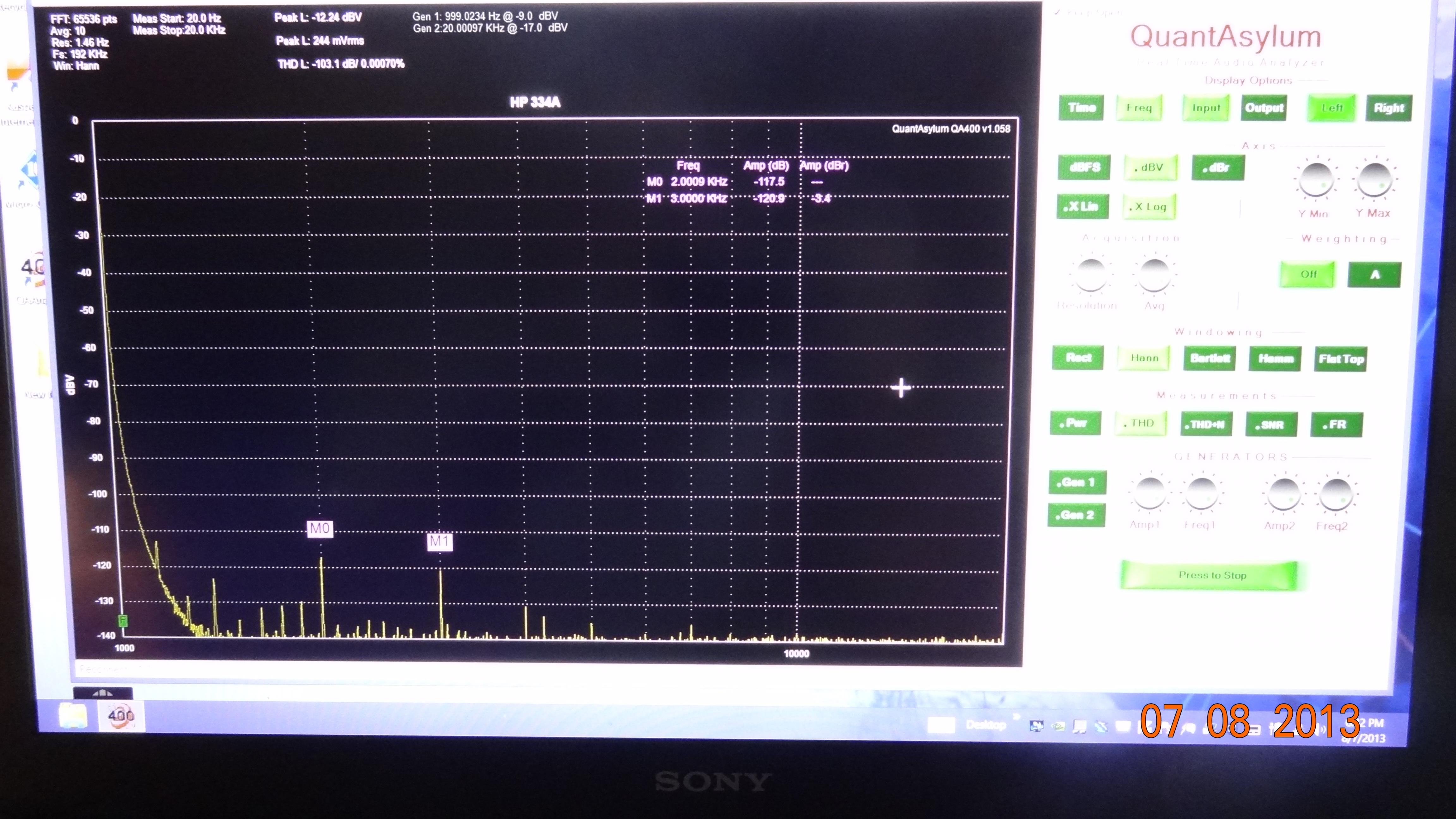

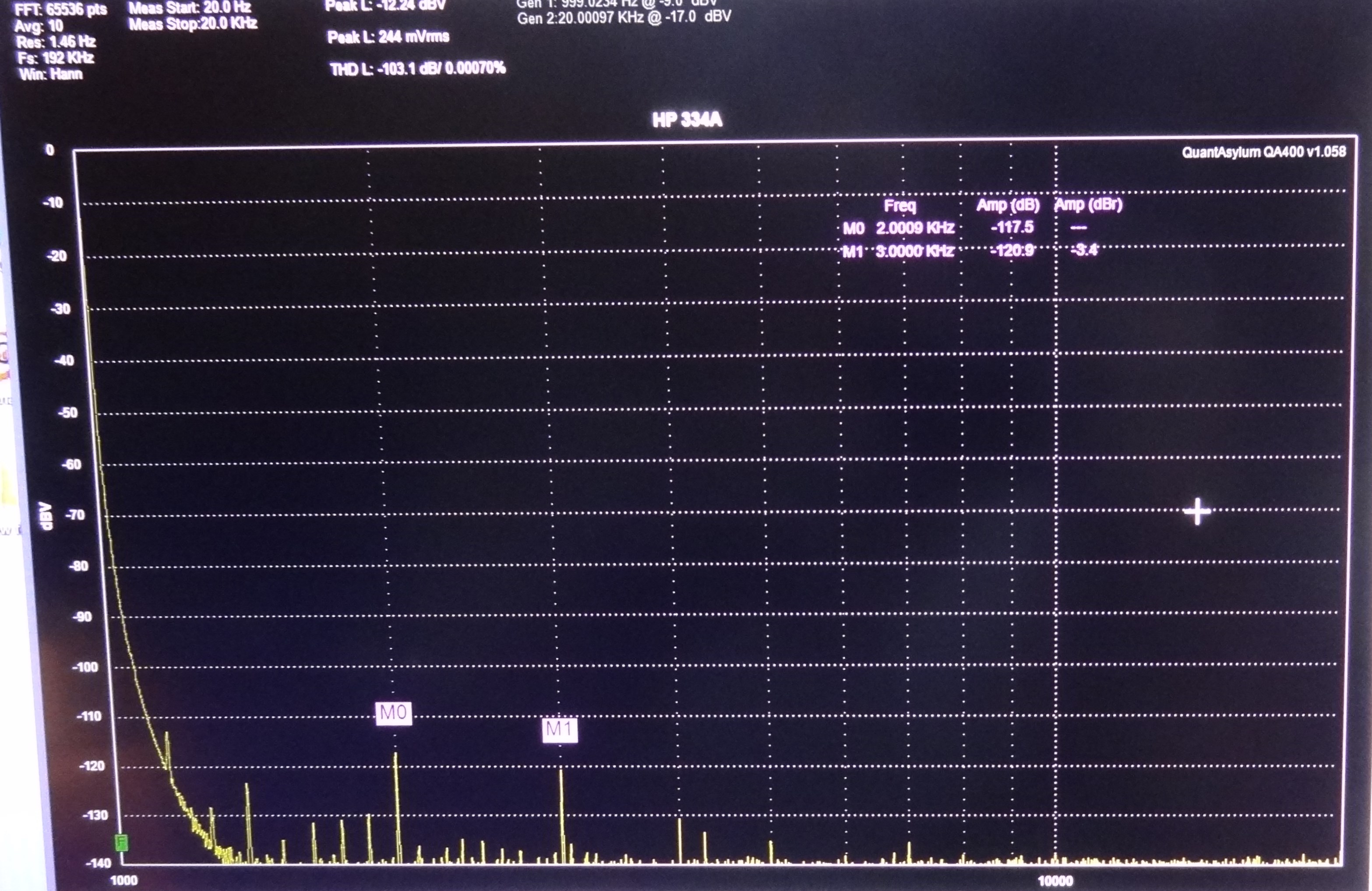

I checked out the 334A a little for its potential suitablity as a variable notch filter..... replaced a few electrolytics with back-to-back electro and bipolar types for lower 2H. Then I recal'ed the input and meter driver/output circuits.... if you use an ADC with FFT, you do not have to adjust the bias/thd pots inside for thier ref voltage number (which assures it meets specs)... just adjust for lowest distortion. I picked up 5dB from that alone.
I monitored the osc input at the 334A input port with a stock QA400. The 2H and 3H indicated about -120dB each. Then, thru the 334A output port (monitor out). Instead of remaining relatively equal in harmonic amplitute relationship, I measured it again and the 2H was 17dB higher. 3H was same.
So, either the 334A adds some 2H or the QA400 adds some... or both...the level is very low going into the QA400.
next... to check which contributes the most to the 2H increase and how much. -RNM

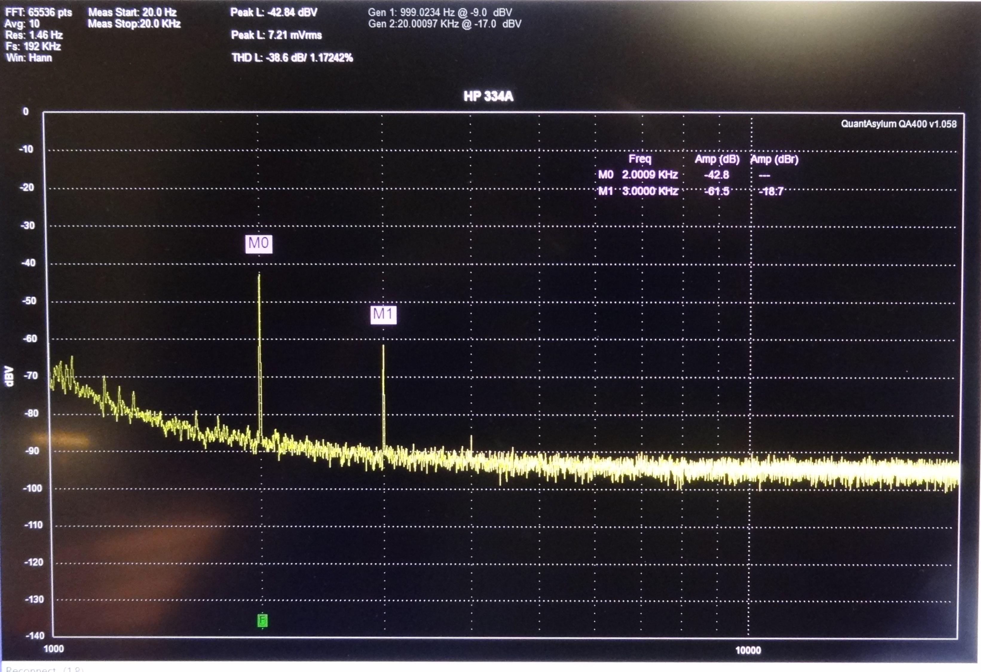

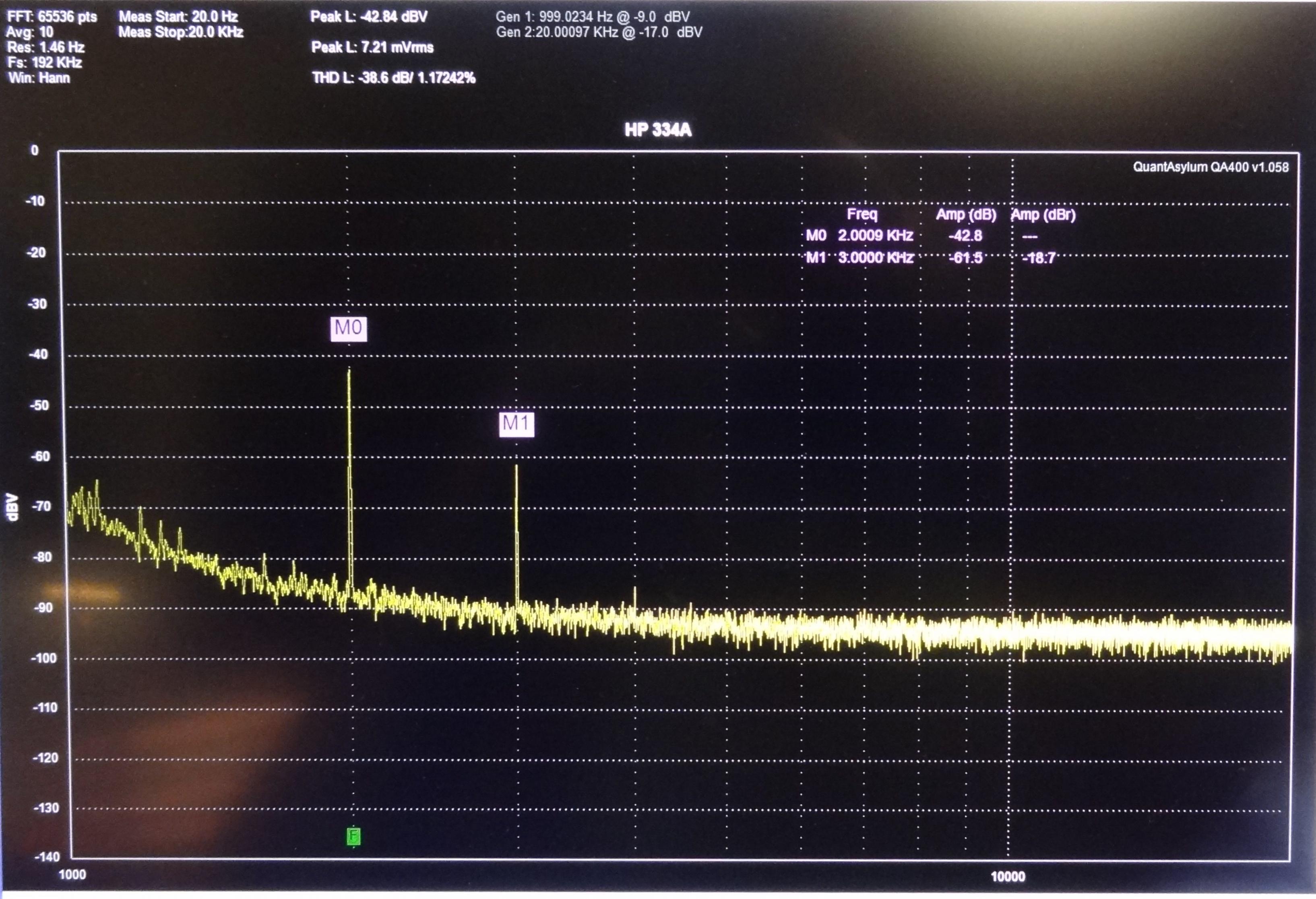

dropped the THD a lot by simple change---
A quick look at the schematic says -from experience- hanging a meter/diode directly on the line is asking for trouble. Needs a buffer from the signal line.

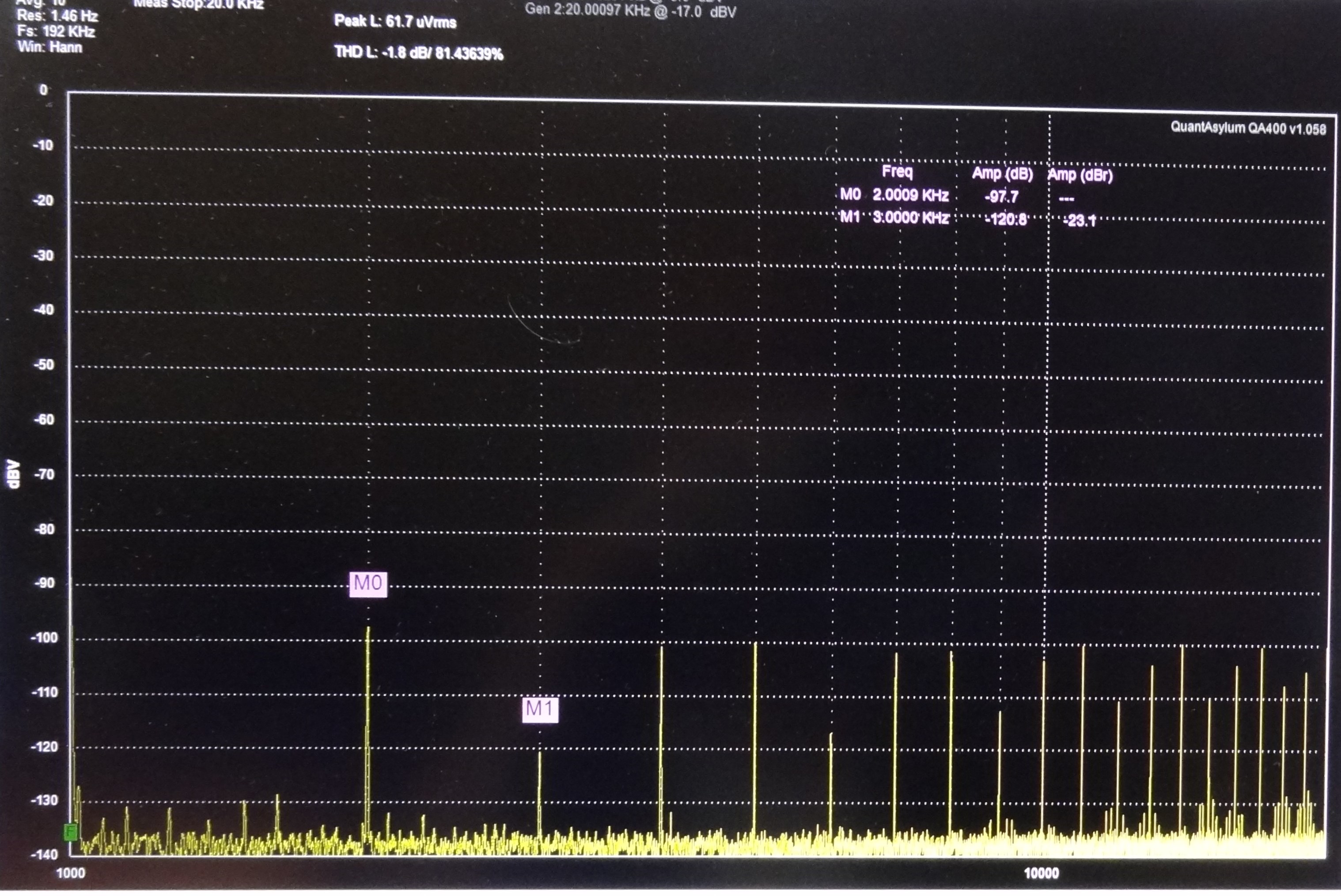

I nulled a 1KHz signal on the front panel meter and at residual monitor output of the 334A via an QA400. I took a residual reading.
Then, I removed a lead wire to the meter movement. All the harmonics dropped a lot (see attachment). I repaced the meter with a R = 1K and got the same higher level as when the meter is in place. Possibly, the amp cannot drive the 1K load without increased distortion. Or what. need to check further for no gain change. Otherwise ->
I will either place a meter disconnect switch somewhere or add a meter buffer... Then, I can try adjusting the bias on the front end amp circuit as well and see if i can pickup a few more dB's.
Thx-RNMarsh
