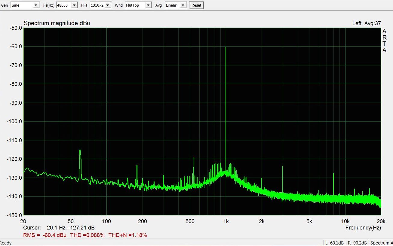

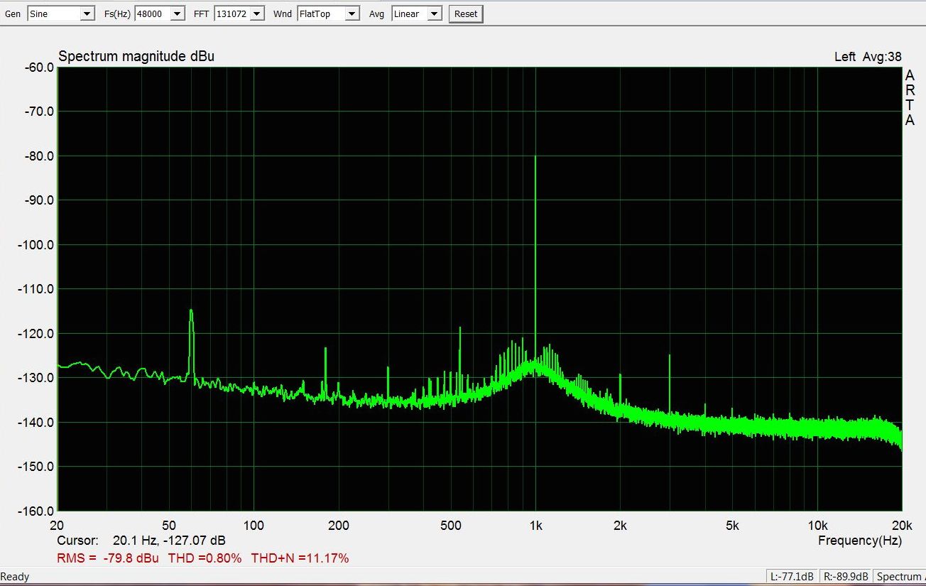

@SyncTronX -- Here are a couple of screen shots that need some explanation. The oscillator is my HP 339A at 3.3VRMS (600ohms source Z) out into a 600 ohm attenuator loaded by 600 ohms, feeding the active Twin-T notch filter.
The ADC is the EMU-0204, which is quieter than the ADC in the QA-400 by a few dB.
The first shot is -60dB notch, the second is around -80dB. The 2nd and 3rd Harmonics are the oscillator's, relatively independent of the notch depth.
Harmonics above the 3rd do not have a clear source -- I don't think they belong entirely to the oscillator, but I have no way of knowing for sure. If some of them are from the filter or the ADC, I don't know of a way to separate them out. I do have an oscillator with lower distortion, but not a lot lower; if, with it, the higher order harmonics change significantly, what is the source? I'm playing in a sandbox that's full of little gritty things, and the microscopes I have to look at them can't resolve the differences. Microbes? Sand grains? Insect poop?

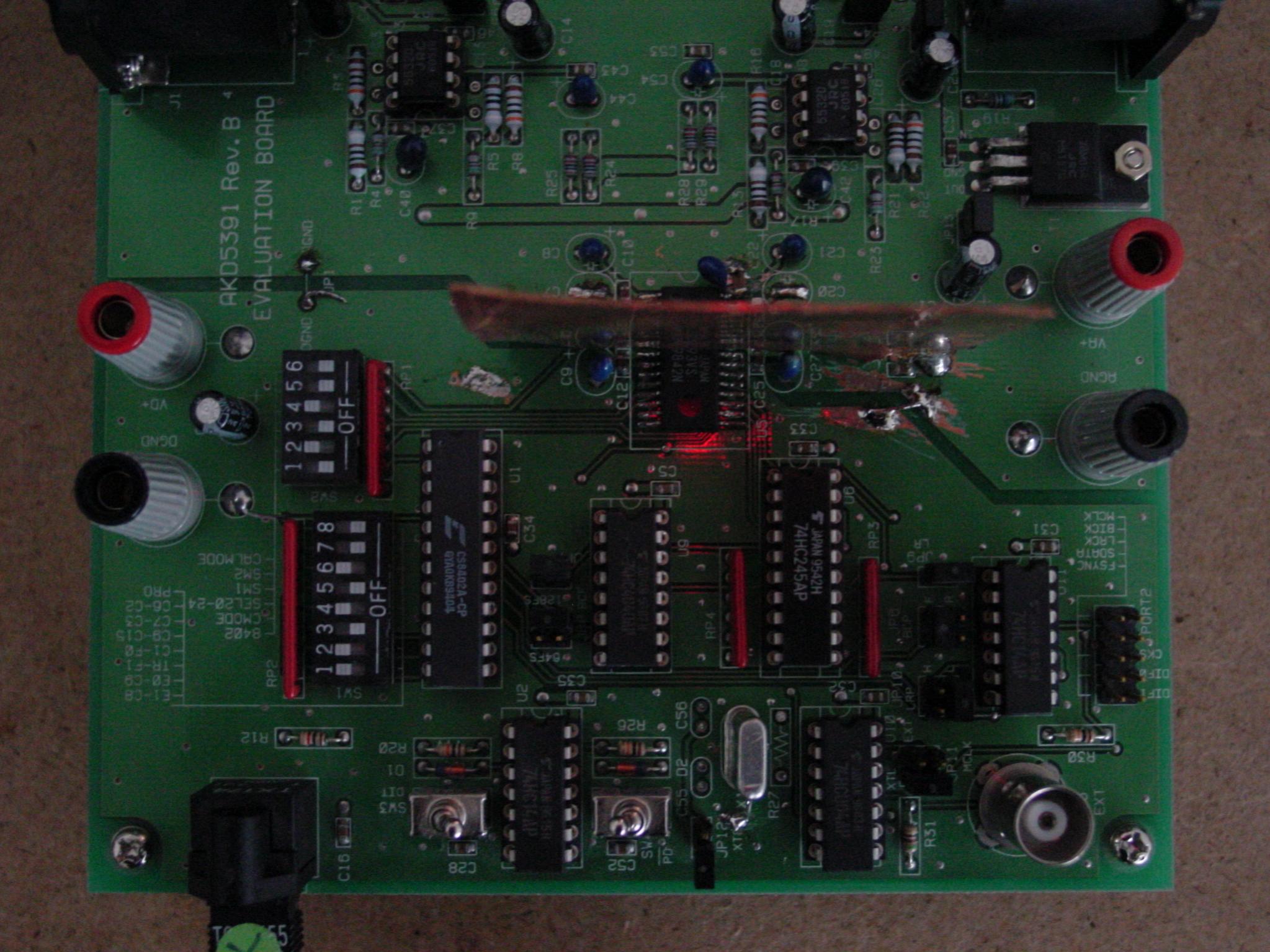

Looking at your FFT Spectrums and my 2 cents about:
1. Keep in mind that your microbes are about 1uV or less...
2. around your 1kHz signal, it looks like symmetric modulated jitter signal caused from the main clock. A linear scaled and zoomed spectrum on 1kHz would tell you more about really symmetric and step frequencies.
3. Interconnection may also an issue, rations or ground currents
4. Test whether your microbes relates linear to the input level
5. Or simple ground the ADC input at your notch and look whether you get
Do deal in uV regions it is not an easy task... sometimes you need some special tweaking....
here a picture what I did to get ride of some side peaks of the AKM ADC AK5394 demo board...
Hp
