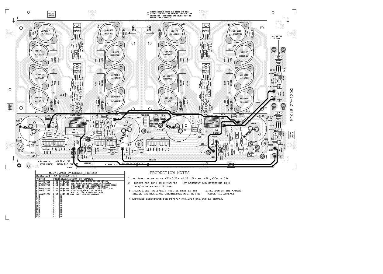

The only BJT amp I've heard that I liked was the Yorkville AP1200... Schematics are online. Just scale down the output stage unless 8 MJ15022 and 8 MJ15023 per channel is reasonable. 300W RMS into 8R.
Here's the output board -

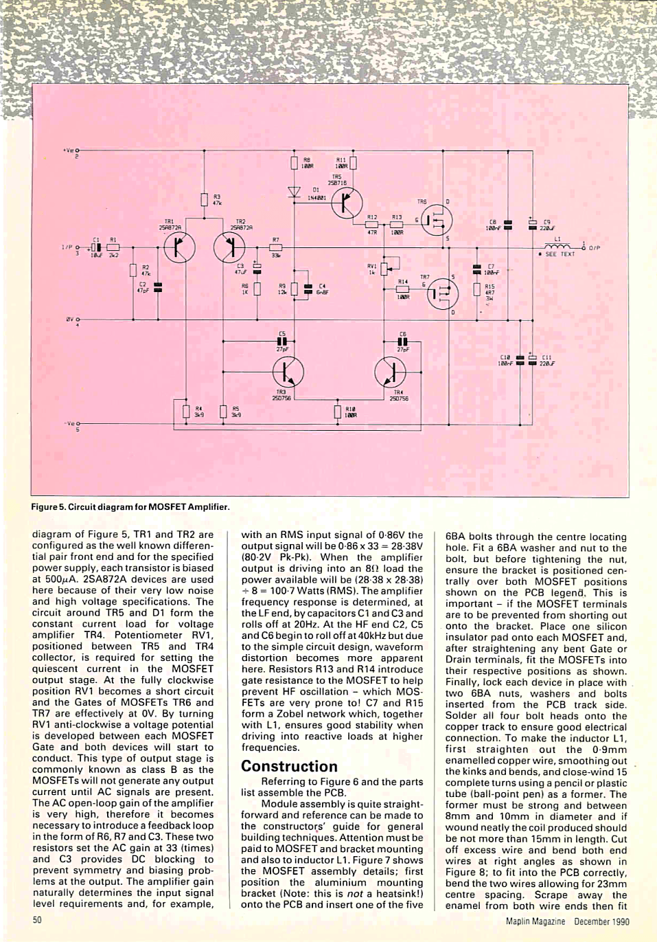

Simple but powerful enough amplifier for beginners and not only
The final stage can be replaced with a bipolar darlington NPN PNP stage
