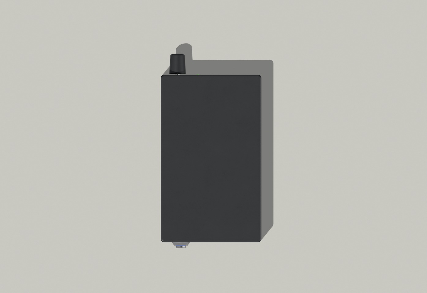

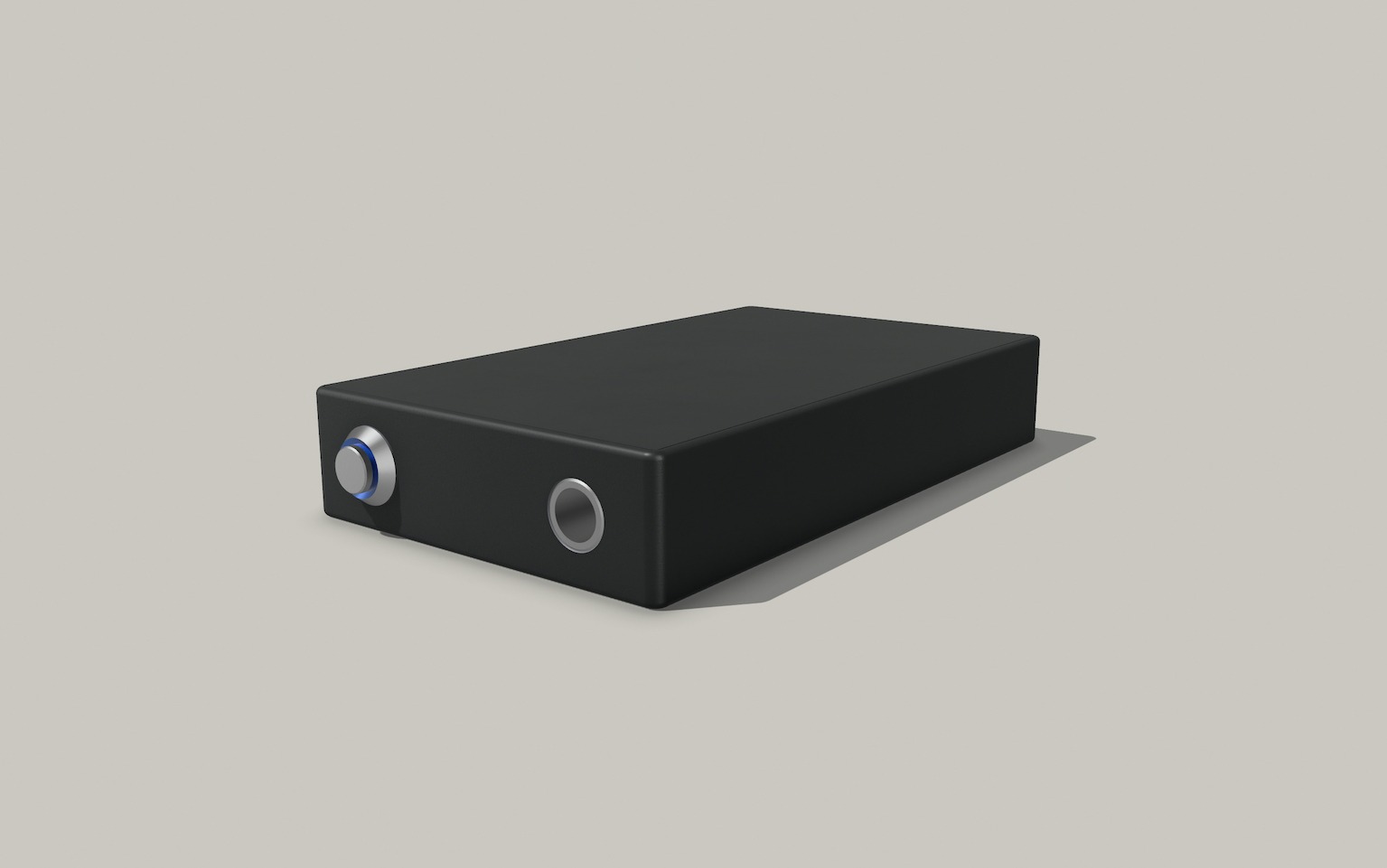

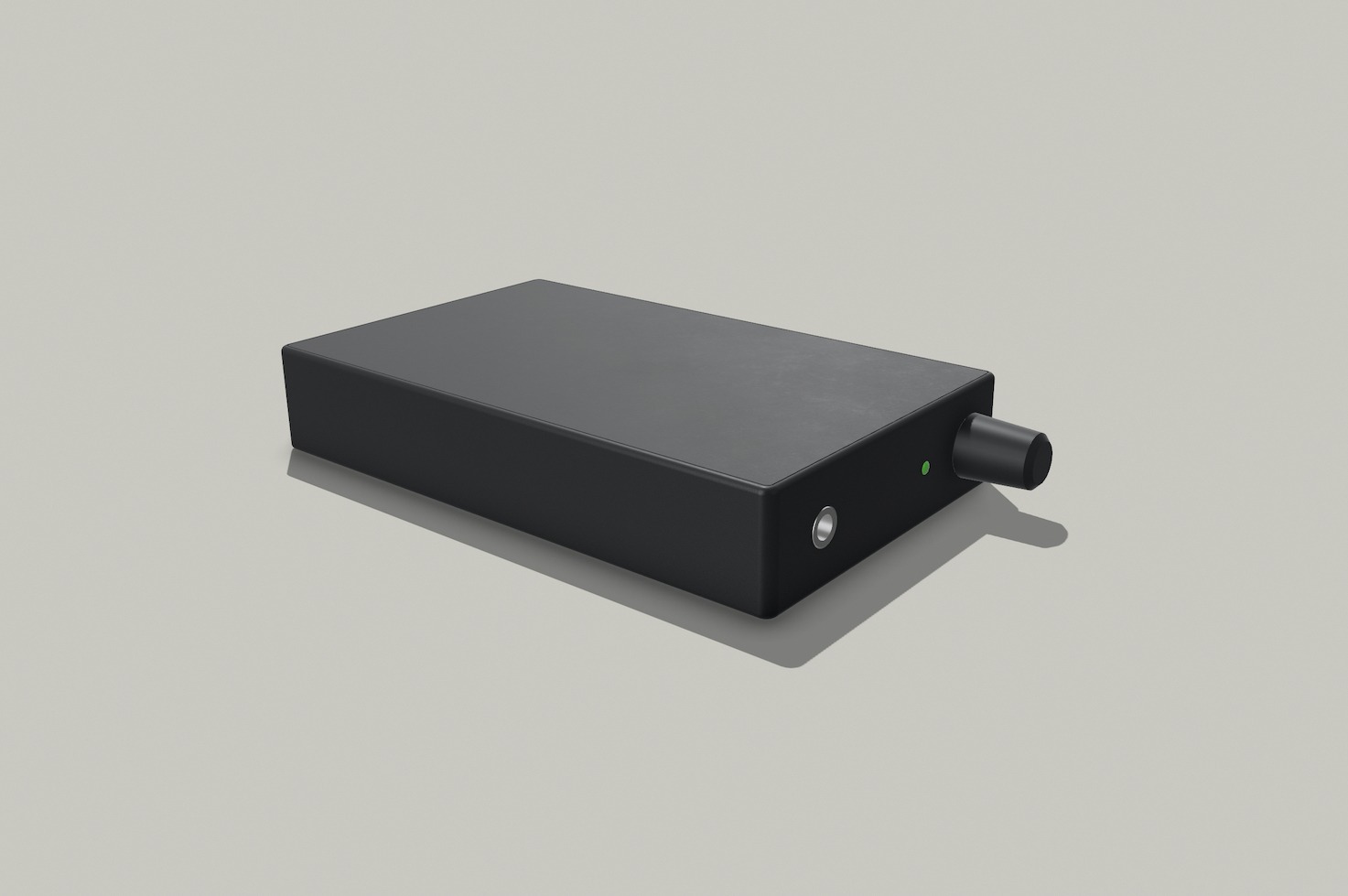

I am attaching you a quick scheme of what I have in my noob mind, and a few fast design of how I see it. Any idea, suggestion, criticism, laugh is more than welcome.
Here a part list (with links) of what I've selected so far:
1) 6.35mm jack audio input
2) On/off switch with led for BT
3) Bluetooth receiver
4) AMP (x2)
5) Volume control (optional for BT)
6) 3.5mm headphone jack output
7) USB-c power module
8) Batteries
Thanks in advance for your precious help everybody!

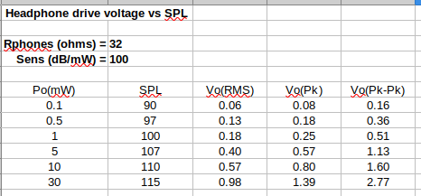

3) Used with headphones, the chip amp you chose can deliver enough volume to destroy your hearing almost instantaneously. One accidental "pop" from a loose cable could leave you with hearing loss for the rest of your life.
Personally, I take this issue very seriously. Deafness and tinnitus are very miserable conditions to have to live with, even more so for a musician.

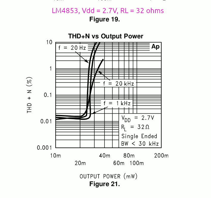

I built my own headphone amplifier not long ago, and I powered it from a low 2.7 volts DC, which drastically limits maximum output power to headphones. I did this specifically so that it could not, under any circumstances, get loud enough to cause instantaneous permanent hearing loss.
4) The board you chose will not run on anything less than 7 volts. That means it will deliver dangerously high SPL through headphones.

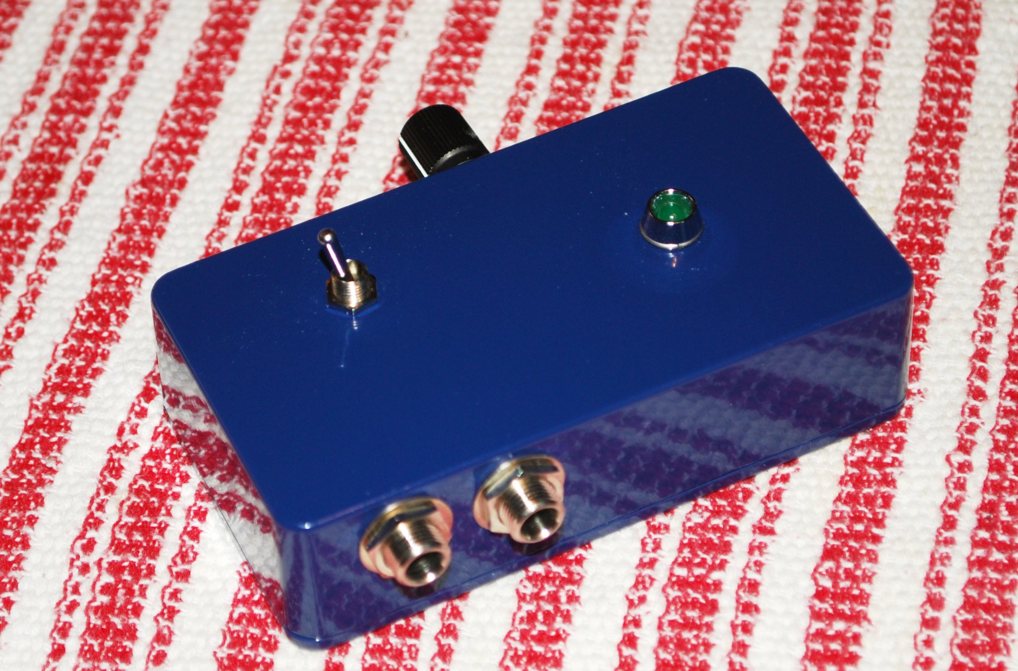

5) How important is small physical size to you? For a DIY build, it's a lot easier to build something into a relatively big enclosure, than to engineer it into a tiny one.
If the Mustang Micro doesn't float your boat, and you want to DIY something, my suggestion is to start simply. First sort out the most important parts: the audio chain, from guitar input jack to headphone output jack. Do you need a preamp? Will you need tone controls? Will you need a compressor of some sort? Do you need any kind of overdrive capability? How will you keep your hearing safe in the face of the unpredictable nature of guitar signals and guitar cables?

I built my headphone amp into a little FX pedal enclosure, with the intention that I would use some other FX pedals in front of it, and power it from the same 9V power supply. So I found a tiny little adjustable switching voltage regulator board, and built that into the enclosure; the actual headphone amp receives only 2.4 V DC, though 9V DC enters the box.

I'm attaching an excerpt from the LM4853 datasheet, showing output power into a 32 ohm load when powered from 2.7 Vdc. (The chip is rated down to 2.4 Vdc, but the datasheet doesn't include a graph at that supply voltage. You can extrapolate down from the 2.7 V graph.)
I'm also attaching a screenshot of a spreadsheet I just put together, showing drive voltage vs SPL for 32 ohm headphones rated at 100 dB@1mW sensitivity.
I'll also attach a pic of the headphone amp I built, just about a year ago. The LM4853 is a stereo chip, and my headphone amp has stereo inputs, which can be driven from, say, a stereo reverb pedal. The toggle switch on top is a Mono/Stereo switch - flipped to Mono, it connects the inputs of the two channels together, so that I still get sound in both ears even if I feed the headphone amp from a mono source.
(You can get the same result using an input jack with additional switch contacts for the left channel; I didn't have the correct jack on hand, but had the toggle switch, so I built it this way.)
I have actually played a bass guitar through this headphone amp a couple of times. Input impedance is too low for a passive bass, but, as it happens, my bass guitars have onboard preamps, so they can cope with the low input impedance of the LM4853. I didn't build in the ability to mix in a backing track, though, which is a huge weakness when used with bass guitar. I may have to try it with a bass guitar and a looper pedal one of these days.
