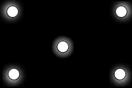

from your explanation, if I understood correctly, my problem is not spherical abb.
Below is the picture to simulate what problem I'm facing, I can't get real good photo, so I made this picture, what's your comment?
thank's
It looks like the smeared parts are only on the side away from the center of the screen. That might be reflections inside the lens. Do your lenses have anti-reflective coating? Any place that makes eyeglass lenses should be able to get them coated for you.
