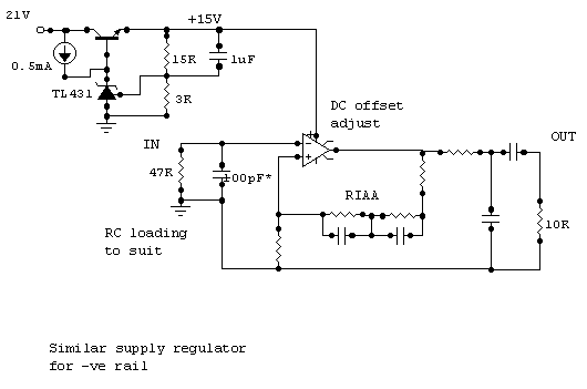

Frankly, I don't like the concept at all - it looks to be a hangover from the misplaced enthusiasm for wideband open loop active stages and passive eq from that moribund TIM dinosaur - an attempt to have constant NFB across the audio spectrum! Except it has substituted narrow OL chips.
I would ditch the passive eq and the second and third stages and wrap the whole RIAA eq around one really good chip like an OPA627 (for UGS) or if the noise still wasn't good enough, multiple matched FETs driving a OPA604. You could do worse than a LT1028 if you're OK with bipolar inputs.
ONE CHIP TO BUY (per channel)
But I didn't want to spoil Mantisory's day, but offer genuine suggestions based on science rather than wooly...

Yes the OPA2134 is a world apart. But still noisy - does nobody notice this. Surface noise must be the reason. It's achilles heel is very poor +ve supply rejection so I would do this-
Now to jUst recall those time constants 3180uS,.... it's been awhile since I'ver done one.
