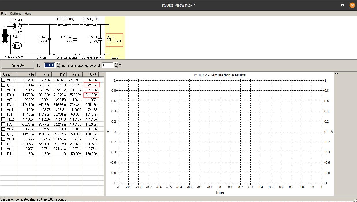

Bug in latest PSUD 2.20.0
When simulating a center-tap full-wave rectifier circuit, the transformer current is high by a factor of 1.414 (should be same as diode current) and waveform shows positive and negative pulses (should be positive only). Both occur only with latest version. And the table formatting is awful - need to resize every column each time I use it.

Thanks for the feedback, I've had a quick look at some of this stuff.
Transformer current high: Did some checks and I'm getting I(T1) = I(D1) for the conducting cycle which is what I would expect. Can you PM me the .psu file that is causing this and I can look in more detail?
Waveform +/-: This isn't a new bug that was introduced, it was the older version that is the bug 🙂 The current will go in one direction on one half-cycle, and the other direction on the next, so this I believe is now the correct behaviour for I(T1), or current in the transformer secondary windings. The I(D1) should conduct on half cycles only and when conducting should show the same as I(T1).
Table formatting: Something isn't quite right with the auto sizing. It looks like the underlying component has changed between 2.0 and 2.20 so I need to fix this. More news soon...

I was just noticing this as well.. Same behavior on two different computers.
In a center-tapped fullwave circuit, the current will go in one direction on one half-cycle IN ONE HALF-WINDING, and the other direction on the next IN THE OTHER HALF-WNDING.
No par of the winding has current going in both directions. This may be the cause of the error in "transformer current".
