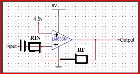

when looking in Operational Amplifier (such as LM833) data sheet , can see that power band width is constant in the audio frequency region.
when passing guitar signal through buffer (consists from LM833 or any similar), high frequency loss is noticed, can any body explain why is that??

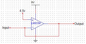

yep the input impedance is much higher then guitars (about 10k),but why should it infect the high freqs?
What would you suggest?

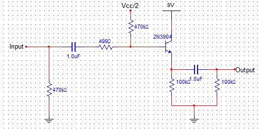

I had attached another buffer in BJT version, also with the high freq problem

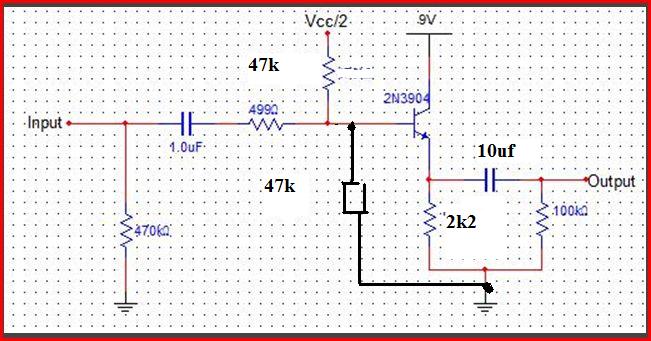

Or try this,
the emmiter resistor needs to be low to give decent output current capability.
The base need to be given a reference voltage of VCC/2 approximately hence the two 47k resistors. The output cap needs to be fairly large to ensure no LF roll off into low impedance loads.
In your opamp above the LM833 isn't ideal for a 9volt (battery ?) Try a TLO71 (single) or TL072 (dual)
The bjt shouldn't lose highs as you put it. Are you certain the transistor is connected correctly ?
It should drive any normal preamp/power amp input OK
The voltage on the base should be around 4.5 and with around 4 volts on the emmiter if using 9 volt supply.
Yes' Vcc is 9v battery,why should it matter which OpAmp (LM833, TL071, LM5532, I was looking for low noise & low dist)?
LM833/NE5532 are a bit power hungry compared to TLO72.
Noise and distortion tbh is the last to worry over here. Noise is also determined by the surrounding components and the values used... honestly, it's a non problem for you here... same goes for distortion. The NE5532 is preferable for driving low impedance loads <2k
Your battery will last several times longer with the TL072... and if battery life is very important there is the low power TL062 (not as well specced).
