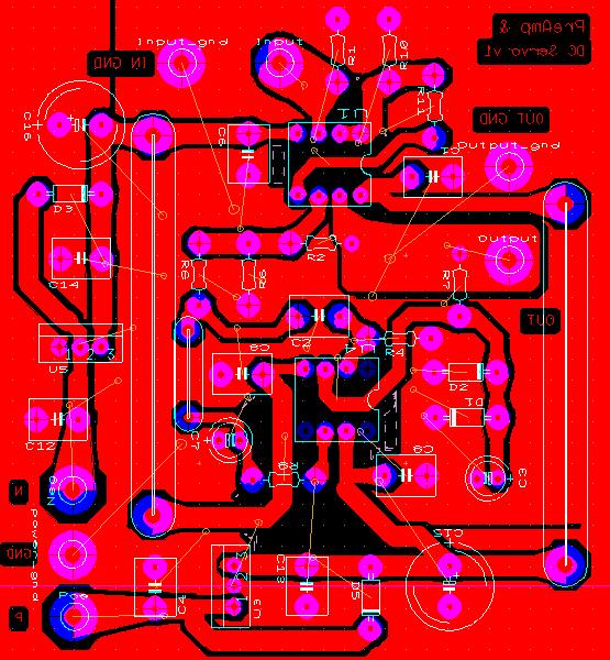

I'm working on a little buffer Preamp to sit in front of my chip amp (lm4780 parallel setup). This is one channel.
The values used are not necessary the values i will use as i haven't made a prototype yet. I'm a newbie so the design might not be up to much (especially the pcb layout 😉).
I would very much appreichiate you opinions
thanks
Ted

C2 is connected to the wrong end of R9.
What are R10 and R11 doing?
Why is R8 so much bigger than R9.
Why is C2 so much different from C3.

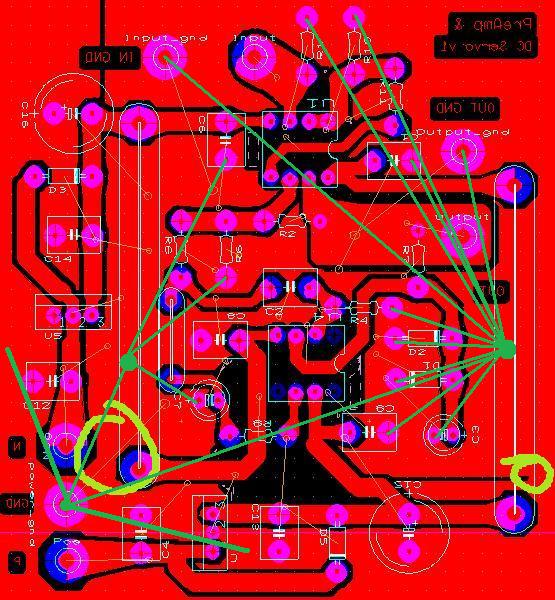

Don't mix your Signal grounds and Power grounds.
Why do you need a buffer with the chipamp?
It should be at the output of the previous source.

The star grounding scheme is divided into three (see attached). Two sections were intended to be the clean gnd which connect to the power supply ground. I'm not sure how effective this is 😉
I'm using the buffer (half the NE5532P) as the source will not always have be consistent (i.e guitar and or various pedals, laptop, cd player etc.)
I've removed R11 and put it at the input to the buffer at 1kohm for RF interference immunity along with a 330pf cap parrallel to ground.
The NE5532p will also be replaced with the LM4562 but i dont have it in my parts library
