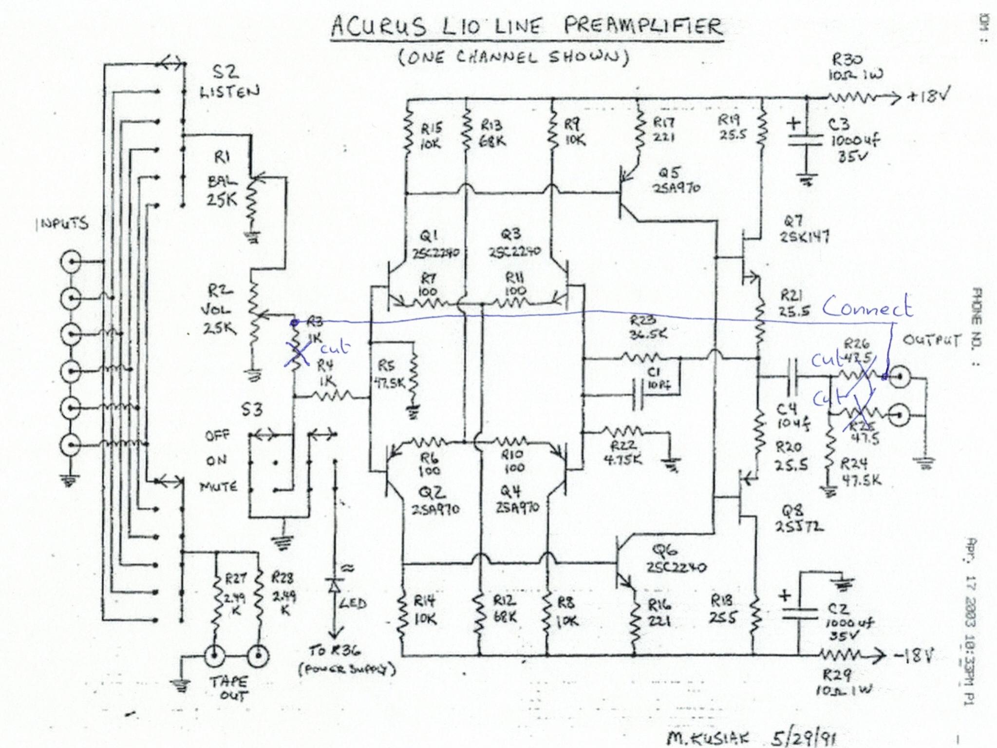

Thanks everyone for your helpful comments and suggestions. I had read the sticky at the head of this section prior to posting this thread and, following its content, had concluded that a passive attenuator might be suitable for my system given its specifications. However, I did want some kind of confirmation before I went ahead.
My current preamp has started exhibiting distorted sound which makes listening to music unbearable. It is an Acurus L10 Line model which I believe is no longer made or sold here. I have no schematic for it and no test instruments (other than a true RMS digital multimeter) so repairing it myself is not an option. Additionally, I would like to build my own unit so this gives me the perfect excuse.
Following some of your comments, I have decided to build a 10K ohm passive step attenuator as my control unit. I will also add a selector switch allowing at least 2-inputs for my CD player and FM/AM tuner. I would like to try a non-electronic solution first. If I like the result, all well and good. If not, I'll next build a unit with a buffer such as the Pass B1, or one with op amps.

Here's an older thread on said Acurus L10 amp with at least a partial schematic:
http://www.diyaudio.com/forums/analog-line-level/241123-acurus-l10-preamp-mods-schematic.html
The power supply section (where I suspect the problem lies) is not depicted but we can infer a few things from the details mentioned. The discrete voltage regulators do not look too complex, shouldn't be too hard to reverse engineer if needed. First of all I would look for the 1000µ buffer caps and 10 ohm dropper resistors on the regulated +/-18V supplies and measure voltages there. Presumably one of the rails has a problem, maybe a cooked transistor or fried zener diode.
Thank you very much, your help is much appreciated. Now that I have the schematic, and your suggestions as to how to proceed, I may attempt to make repairs myself. At least I'll give it a try and see what I can do. Nothing ventured, nothing gained and if it doesn't work out I still have the option of building a passive volume control.
