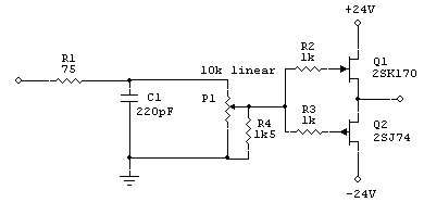

Buffered Passive Preamp
Im going to use this pre-amp with this amp that i have..

Freddie said:
This is a pretty nice buffer. Perhaps I have to try this one too...
/Freddie

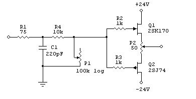

You could try this one...
I use it in a version of Jocko´s I-V stage.
I use 2SK170GR so the current is only about 2 mA,but now I have got some 2SK170BL´s so I should be able to get more current out of it.Don´t know if it sounds better but it should not sound worse...
Adjust R2 for the lowest DC out,my version is stable within +-1mV.
/Nicke
