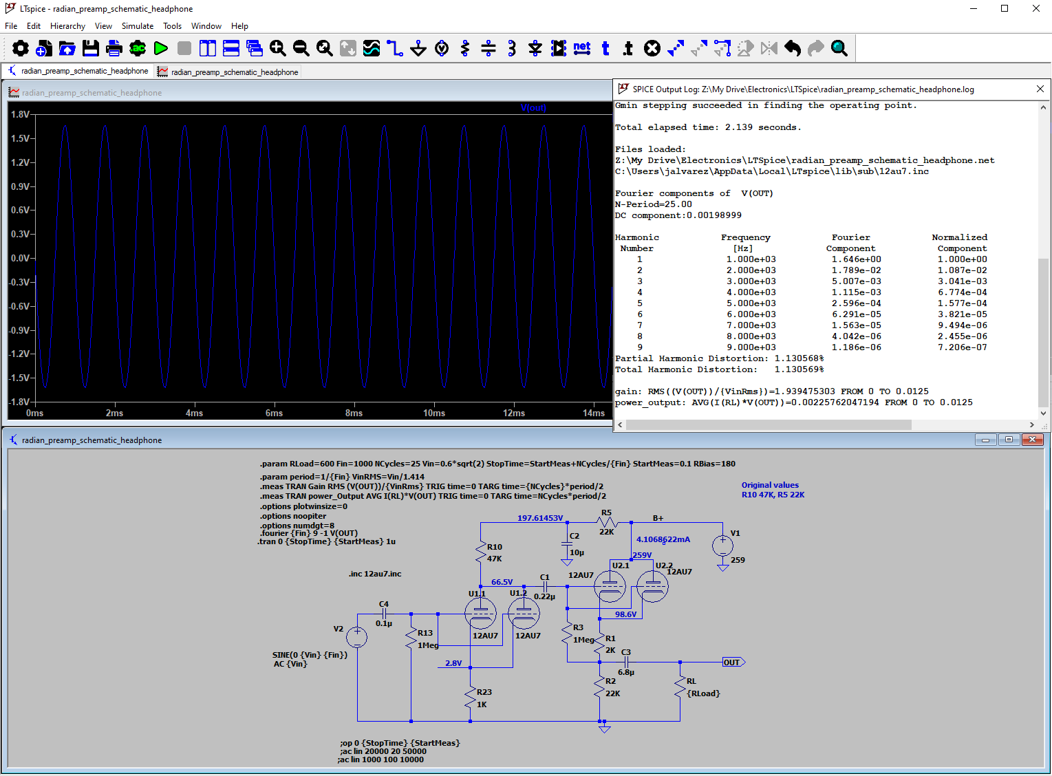

Even the original schematic can handle the CS43198 DAC chip output of up to 2V RMS, without going into grid current. That was may point. Is it the best schematic for the job? I don't think so. Does it work? Yes.

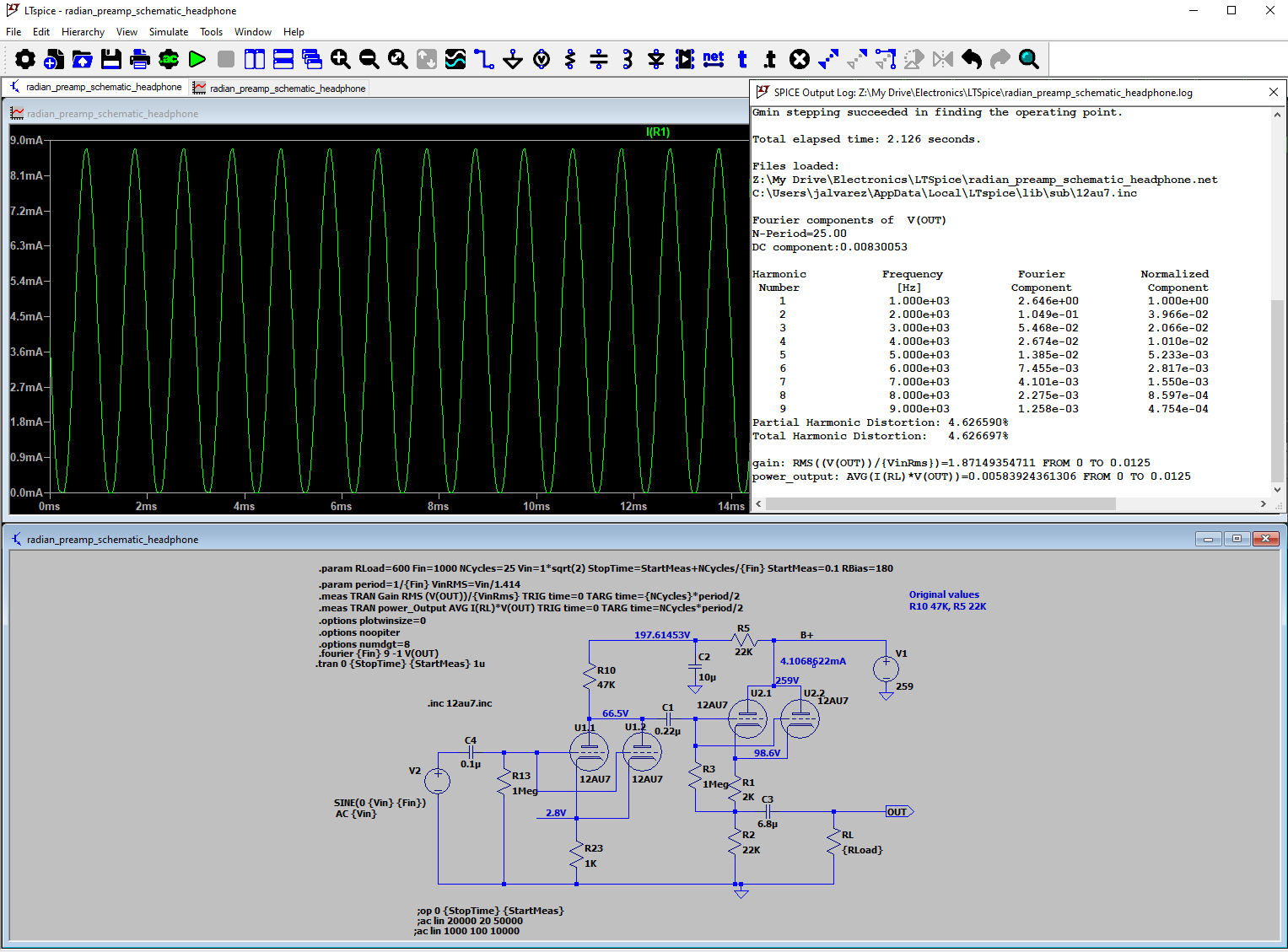

As expected, not pretty. Current through output triodes reaching zero with 1V RMS input, 1khz, 5.8 mW onto 600 ohm load.
Rebiasing the output stage would make, of course, things better. Also, the output cap needs to be increaded, it has a big impedance at 20hz. But it's really not a good design for a headphone amp.
