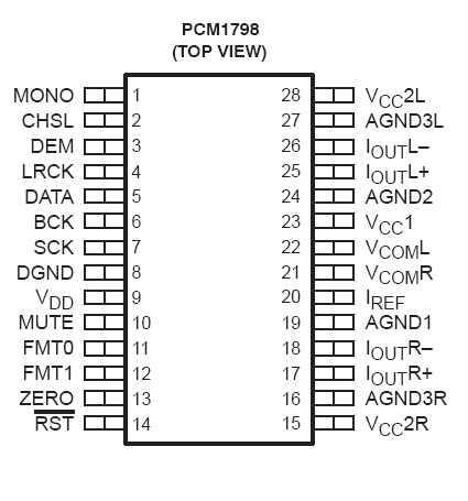

I want to do something like this.....but I am not sure how to do it right.
The DAC has system-clock input, but no output. If I feed the DAC directly from a Tent, or KC7, the signal that should go back to my player could NOT be connected to the clock in parallell....right ?
I need some kind of buffer, maybe the 74HC125 will do here to, but do I feed the DAC, and the logic with the same signal directly ??????????????
How will the SMD-part and "one-port"-logic 74AHCT1G125, or 74AHC1G125 do here ?
With this logic there are onle one port pr. package, but I am not sure AHCT, and AHC will do.<..... and NEVER use more than one inverter per package (use the one closest to the gnd pin), >
Lyra

Take a Tent or KC7 at the freq you player needs. Divide the clock to the freq your dac needs. Feed the clocksignal back to the player. Use a async fifo before the dac. clock in on incoming i2s clock, clock out on the clock from the Tent or KC7.
There is a post around here from somebody who got away to do this without a fifo, but you could run into timing problems.
I did something like the above for tda1541 dacs with 11.xxx MHz player. Works fine, have a look here:

Does it have to be done that complicated ???
....especially when the clock-frequency required by the DAC is the same as for the CDP...?
What will happen if I just buffer (74HC125) the clock, and feed the "same" clock-signal to both the DAC and the CDP ?
This is the same as if I leave the clock in the CDP, isn't it ?
....and I don't need to split the I2S signal in right/ left signals as I am using a PCM1798 Stereo-DAC.....
Lyra

Lyra,
As i said before, it does not have to be so complicated. There is another post around here from a guy who has done this without fifo. But you might (!) run into timingproblems. Depends on timing: i2s direct or spdif inbetween. If the DAC clock toggles when the data toggles at the same time, you have a problem.

I try to build a PCM2707 and PCM1798 in two seperate boxes. PCM2707 will output I2S signal to PCM1798 connected using a CAT5 cable for LRCLK, DATA, BCK AND SCK.
Some questions need advise:
1) Which format is better for connection using cable? I2S or SPDIF? I chose I2S because i got the impression from the forum that it is much better than SPDIF.
2) From the discussion above, SCK is not present in the transmission because NOS DAC doesn't required it. But in my case, I need to transmit SCK. What will be the problem if I transmit SCK using cable?
3) Is buffering the I2S signal really neccessary when transmit using cable? If I use short cable lenght, can I ommit it?
Thanks in advance for your help.
