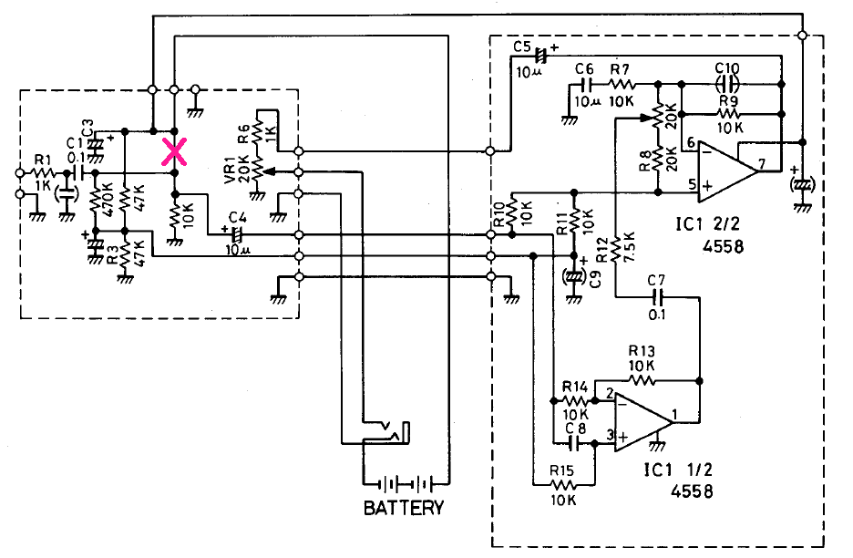

I am working on a buffer amplifier/ mid boost circuit. Here are the original schematics but are not accurate. My primary concern is the capacitors at C1. On my pcb, there is only 1 capacitor. The schematic shows 2, one of them in brackets.
My PCB also includes an F30A transistor
The unmarked cap looks to be for RFI protection and may well not even be needed. If you want to fit it then something like a 2n2 would be fine.
That diagram is *wrong*. Note that the battery + is connected directly to the 10K and the input signal. Can Not Work.

EDIT - ah, this is one error swatted. There may be more?
