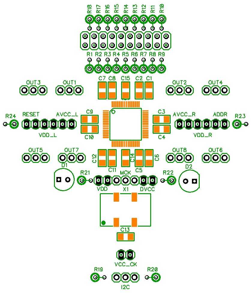

Ok Russ, now that I have your attention - what ground topology are you applying to the tweakers board? Most of the ancilliary components will be off-board according to your rough sketch of the up-coming tweakers board.
All I see on your board is surrounding PS bypass caps & clock - all of which could be accommodated on this prototyping board:
I also have a notion that the improved PS & clock which could be applied to this would more than offset any small sub-optimal issues there might be with this prototyping board
When did you not have my attention? Would you rather I leave you to yourself?
You need to think about the GND plane.
Also that pic I posted was a very rough sketch, it has changed since then.
Read the ESS design guidelines and then you tell me how you could come close to complying. 🙂
Also bypass caps need to be very close to the pins and directly connected to the plane.
You then need to route all outputs along an unbroken GND plane.
There is simply no way you can do that using a protoboard.
Anyway have fun. That's all that counts.
Cheers!
Russ

Hi John,
It's an interesting idea. As Russ says I think the biggest issue will be getting routing and earthing optimal. Tricky, but I don't think impossible - with the proviso that you really know what you are doing and have the measuring equipment to back you up.
Me, I'm still waiting for an ESS9018 to turn up in the post. I'll be grafting it onto my Buffalo mark 1 board.
Thanks for the link to the AOS forum by the way - interesting reading about Leo and Roll's experiments.
Dan
Hi Jkenny,
I know it has a GND plane, the problem is that the supply traces are going to be far too long and thin.
Give it a go, just warning you that there will be some very significant design compromises that will effect the final result.
You simply have to design for the application you want from the start to get the best results. This involves careful deliberate design and layout.
Remember you are dealing with an 80mhz clock (if you want to do 192/32 SPDIF/AES). This requires better layout then you will get on a protoboard.
Glad your having fun.
Cheers!
Russ

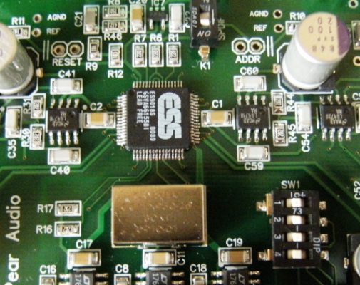

Attached photo of ES90018 board with some long (& some thin) traces in evidence - maybe not critical!
jkeny said:
Dan, do you have access to such an animal? What are you planning for the removed ES9008 DAC?
No, those traces have to be long, they are not supply traces or routes to decoupling caps. 🙂
The only long traces are analog or control (things like LEDs and the I2C). And the analog traces are carefully routed over unbroken GND.
All of the traces that need to be short are short. 🙂
The decoupling is actually better than the ESS demo board in terms of length etc.
Cheers!
Russ
