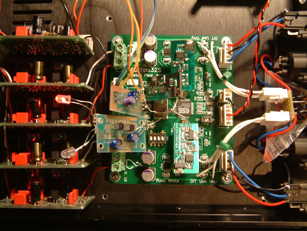

OK. I think I'm done now
Out with the buffer op-amps and in with a couple of 3v3 shunts for Avcc.
It looks like Frankenstein but sounds divine..... I think the Avcc "upgrade" makes an evident improvement, but I will have to listen more before I can pinpoint more precisely where the sonic improvement are. I may try some different supplies for VA and for the VD JSR that now has to cope with about 0.7A current draw for the 5 mini regs.
Other than that its time to box it all and enjoy!
I'm just waiting for AC1/Femto from Russ and Brian to close this up for a few years and focus on my power amp...........

Thanks for sharing. 🙂 I think I should replace the digital in screw terminal with connectors like you did.
How big of an improvement is the AVCC mod (compared to the VD/XO mod)? What's the main reason that you picked this approach over the one that's described in the manual?

Hi Nic
I see you've soldered the regs diectly across the decoupling cap's pads, like Leo did. Is this cap the original 10u ceramic?
I did it like this, so I could try other decoupling caps, and so the regs were soldered to through hole pillars for robustness. (Ignore the fluff!). Disadvantage is the increased distance of the reg to the AVCC pin

I think the improvement with the Avcc tweak is bigger than with the VD/XO mods. The biggest change was however better VA power (the first thing I did).How big of an improvement is the AVCC mod (compared to the VD/XO mod)? What's the main reason that you picked this approach over the one that's described in the manual?
The Avcc mod described in the manual does not change the power source for Avcc only its absolute voltage - as far as I have understood.
It was a walk in the park mounting the regs on the decoupling caps and as I'm not very likely to proceed with cap rolling experiments I simply left what was there in.

Bloody good regs aren't they Nic😉 upgrading the AVCC regs on the Buffalo24 proved to be a very worthwhile upgrade so doing the same on this dac would prrobably give same results
Yes they are quite extraordinary - and even if a new improved DAC will come out the regs will be recycled🙂Bloody good regs aren't they Nic😉

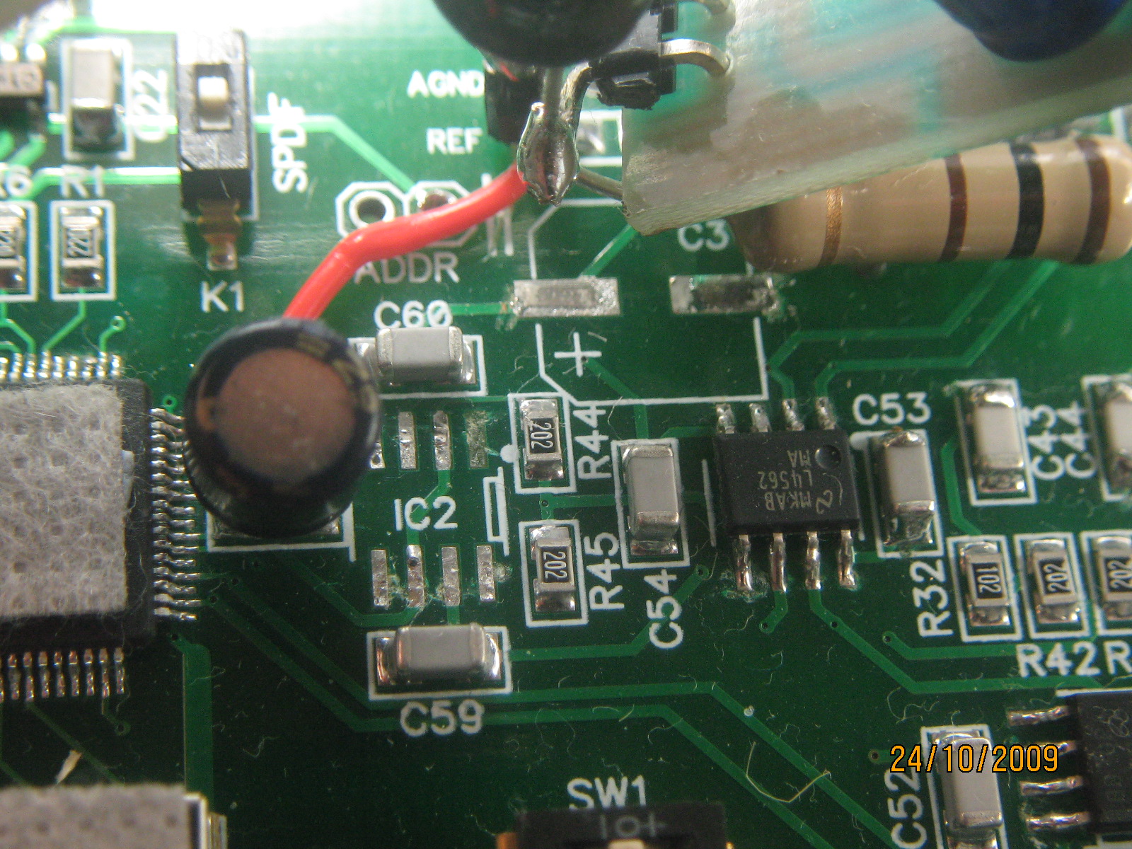

So basically, all I have to do is remove IC2/IC3 (or is it okay to just lift the output pins) and mount the regs on C1/C2?
Thank you in advance!
I guess lifting the output pin is sufficient but in that way I guess the op-amps would continue to dissipate heat. I also removed two electrolytics to get space for the new regs.So basically, all I have to do is remove IC2/IC3 (or is it okay to just lift the output pins) and mount the regs on C1/C2?
Thank you. Now I can proceed right away! Of course, by right away, I mean 30 days later (if I'm lucky). I guess that's the *only* major flaw of the PH regs.
