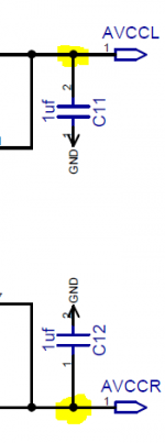

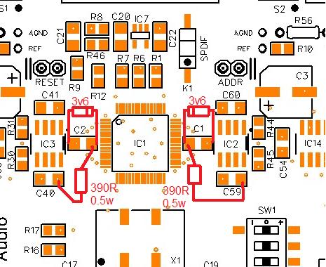

OK Guys here is fun little mod that works well.
Do this at your own risk. Mods are not supported period. 🙂 But they are fun. So if your hip, then go for it.
First to do it you need a fairly clean stiff regulator into VA+ and VA-. LCBPS is just fine. Placid even better.
Next you need to set those to 15V. (probably there already).
Now Grab a metal film 390R 1/2W resistor.
Connect one end to +15V and the other to AVCC(at the bypass cap).
You now have a good constant current source feeding the AVCC input just a tad more than it really needs, which the opamp will nicely dispose of the excess to keep at the reference voltage(3.3VDC). The opamp on AVCC now is a shunt element, or rather the combination is a whole local shunt regulator. The opamp is also now having to do a lot less work, making it work better.
Yes the resistor will get pretty warm. This is normal.
Now you have a shunt regulated AVCC supply. 🙂
Will you hear a difference??? I have no idea.
I found it pleasant.
As always have fun.
PS, yes you could use a CCD, JFET, or any other current source will work well (some better than others). You will want about 30-35ma per channel.

Hah, Well I have. 😉
And just for reference. the reason I was looking into it was really because I have been thinking for a long time how to keep those opamps running a bit cooler.
This seemed a good thing to try, and it worked very well.
If there is any change in the sound of the DAC it is very very subtle. 🙂
But those opamps seem a lot happier, and they should enjoy a longer life. And that was really part of the goal.
