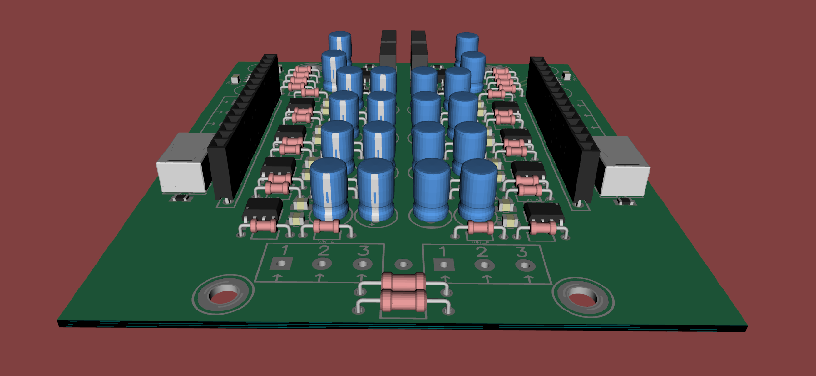

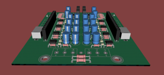

Here is a little sneak peek at the stereo pro IV stage - some details omitted intentionally. 🙂
It's very nearly ready for prime time.
