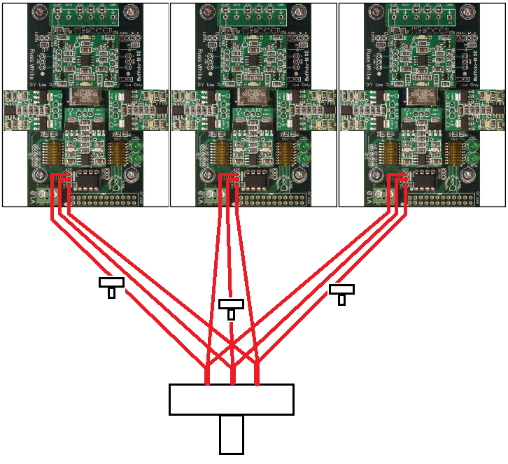

I have a setup following a dsp that looks like this. The master volume is done by
use of one linear pot connected as shown in the picture.
I'm wondering if it would work to ad trim potentiometers to each channel to
be able to make individual adjustments of output level ?
If so, to wish pin should the trim potentiometers connect ?
If this will not work, would it be possible to make the idea work using a 4-gang master volume pot instead ?

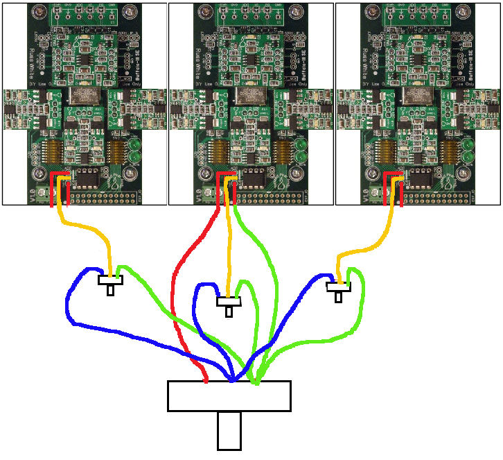

You should use only one 3.3V connection, not all three. That is putting the voltage regulators of all three DACs in parallel. The 3.3V represents the maximum level signal to the ADC on the uC (RED).
Additionally, you should only use one ground connection, and tie the three DAC grounds together at the supplies. This will prevent forming ground loops. This will give all three ADCs a common ground reference. (GREEN)
Now, for the trimmers...
Use the output of the master volume as the "max level" for each trimmer (BLUE). Then feed the output of each trimmer to the DAC boards (ORANGE).
The effect will be a single master volume, with three individual trimmers that will provide limiting adjustment for each DAC. Full setting on each trimmer will equate to the master level.
