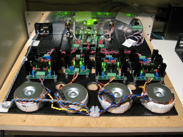

Why do you need four transfomers and dual placid regulators?
He does not strictly *need* them, but it looks to me like he is powering each section of the legato separately which is an option.

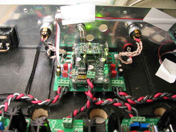

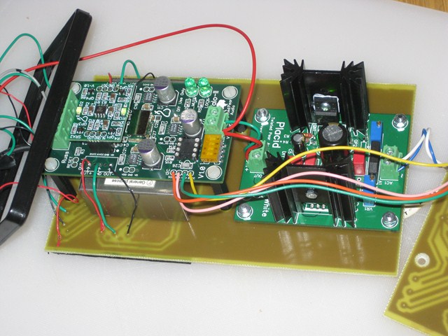

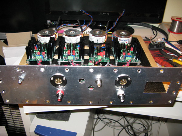

Hi, I'd like to share my success story. 🙂
I just got my BII finished and hooked up.
It's a BII + Placid + Volumite + Toslink kit with Lundahl LL1588 transformers on the output.
I haven't had the chance to sit down and make a serious comparison but so far I like it. 😀
Very smooth, detailed and with lots of air. It's just music playing effortlessly and relaxed.
Are you running a Placid in that, to my eyes, closed enclosure ?
Keep track at the heat dissipation.
Thanks for the heads up. 🙂
It's all aluminum with built in heat sinks but I'll keep an eye on the temp.
