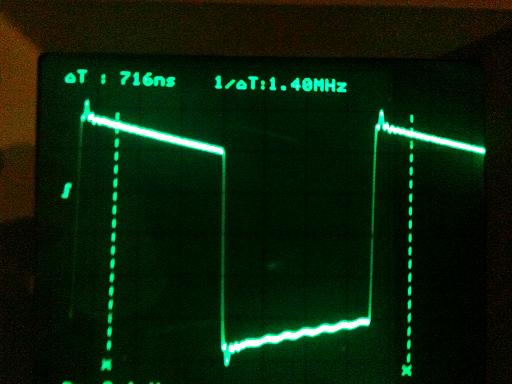

Hi
I use the SB Touch spdif out; removed rca contact and soldered a 75ohm coax direct on Touch pcb wired to Buffalo II spdif input.
Here is how the Touch spdif signal looks like into the Buffalo II (0.1V pr div):
I think this combination is good.
Best
Tom
