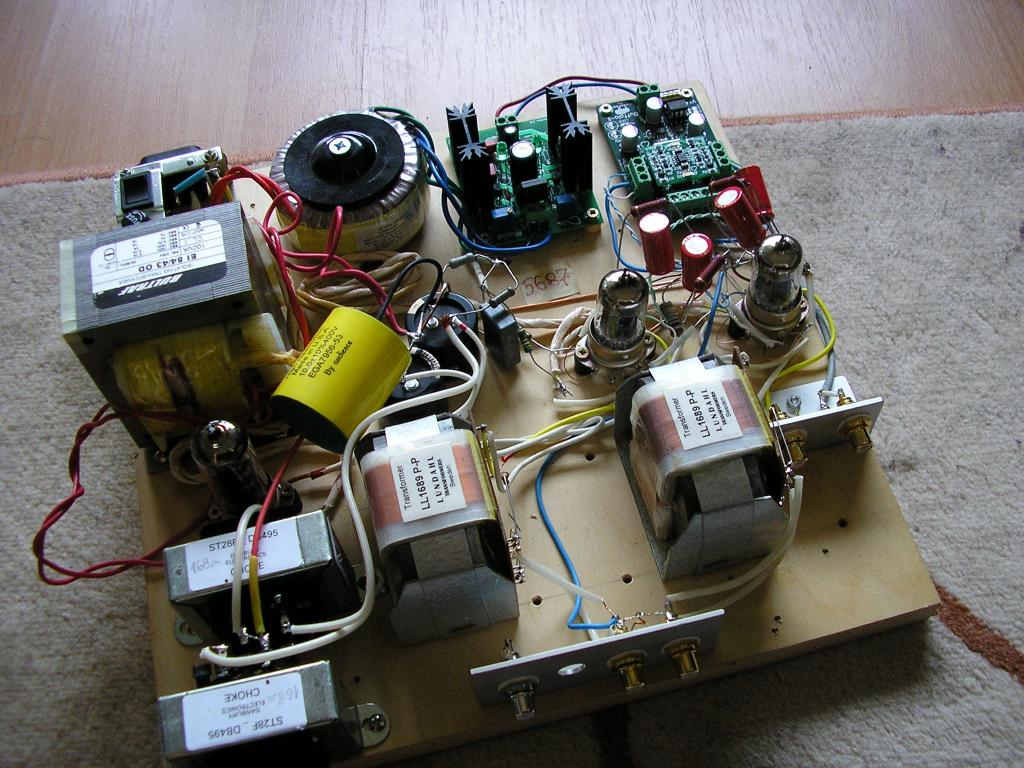

I promised to post a picture of my Buffalo and here it is, it is actually old now as I have taken care of some of the things that everyone would kill me for regarding arrangement and choice of parts and wiring and it is going to be placed in a nice modushop box but will take time. I promise it will be as beautiful as it sounds.
hmmmmm, groupbuy 🙂
