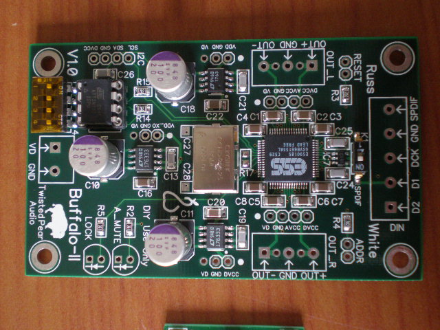

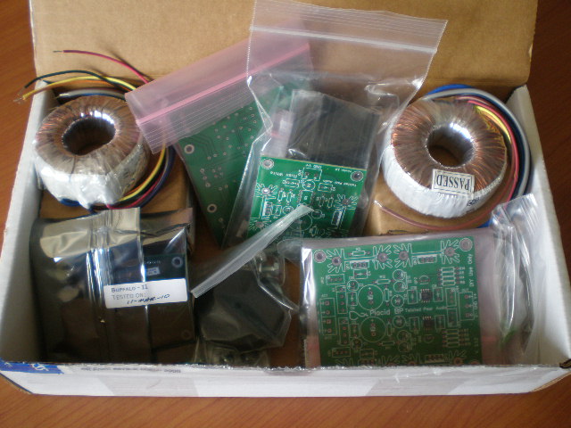

... today I am very happy with my package arrived in the new Buffalo II, and the new IVY III.... 😀
Now I can compare with buffalo dac first series.
I keep you updated ....
