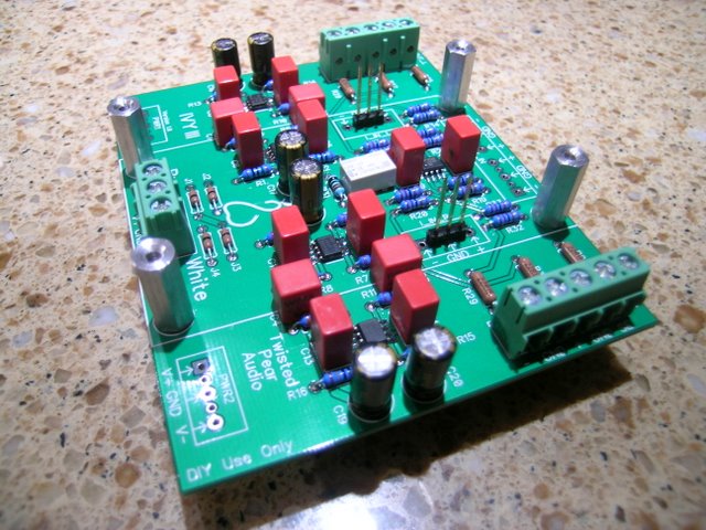

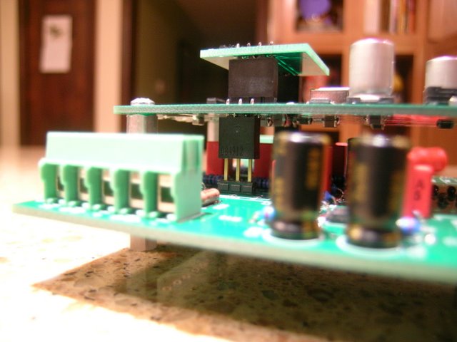

Hey guys, I wanted to post these pics here just in case Brian is not able to get the manual up on our site before you folks need to start building.
For BUF-II there is not much to tell.
Use 15V rails. Stuff all the parts including J1-4 if you want to use a single bipolar supply.
Cheers!
Russ
