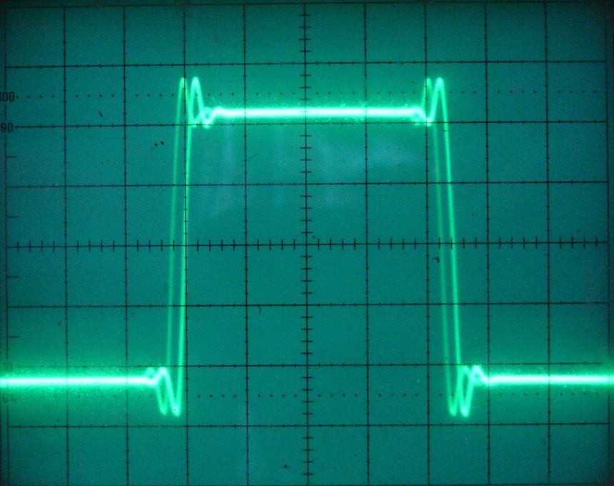

bear said:This is now a very long thread, can any one point me to a post of what a square wave looks like coming off the DAC
Here is a 1khz square wave full output - please excuse the shadow - my ancient scope is on it's last legs.
A 10khz square looks more like a sine with some irregularities but my scope would not trigger it so I cannot post a coherent image
I should add that this is with DAC in voltage o/p mode with a high speed discrete component op amp acting as balanced to unbalanced & filter
The -3dB point of the op amp is around 200khz so the filtering and ringing that is visible is essentially from the buffalo.

This is the best I could get for a 10khz square wave
As far as I can see this is 3 peaks followed by a peak with a trough
perhaps 11.025khz would have been more regular - not sure - on my cd I only have decades
I'm amazed that such a crazy handling of a square waves of certain frequencies could come from a DAC that sounds so great. perhaps that's just how red book digital is.

Hi Mike,
Your shots almost look like the DAC is in Slow Roll off mode.

I thought "surely Mike's shots can't be right" so did some measuring myself ..... and blimey, mine look just the same in both fast and slow roll-off modes. Strange ..... 😕
Actually, putting aside the scope triggering problem, that's a very typical 10K square wave response. As you know, a square wave is devolved into the fundamental frequency, and a diminishing infinite number of successive odd order harmonics of the fundamental, with zero phase shift.
The first problem is that the first odd order harmonic is 30KHz, already way down the the sharp cutoff filter starting at 22KHz. The next is 50KHz, almost non existent in amplitude, probably 30 to 40dB down. Square wave analysis in an frequency bounded system, like RBCD (20KHz) is pretty meaningless above 1KHz or so. And that's a pretty nice looking 1KHz response!

tailspn said:Actually, putting aside the scope triggering problem, that's a very typical 10K square wave response. As you know, a square wave is devolved into the fundamental frequency, and a diminishing infinite number of successive odd order harmonics of the fundamental, with zero phase shift.

Russ White said:Your shots almost look like the DAC is in Slow Roll off mode.
I guess the difference between what you would expect to see and my scope shots would be the different filters we have in our output stages.
I reigned mine in just enough to avoid upsetting my amp

Well, I was under the misguided apprehension that a slow roll off digital filter was desirable because it would give rise to less ringing . . .
Having just switched to fast roll off ( for the first time ) and checked the waveforms I cannot see any difference in the ringing at all.

mikelm said:Well, I was under the misguided apprehension that a slow roll off digital filter was desirable because it would give rise to less ringing . . .
That's not ringing you're seeing, that's the Gibbs phenomenon. There's no way to get rid of it. It's expected.

Try looking at the impulse response in the time domain to see pre-ringing. The slow roll-off filter will reduce this. But it will also reduce the extreme high-frequency response. Some people want this intentionally because they believe anything in the 20kHz-22kHz "transition band" is likely to not contain useful information anyway.
