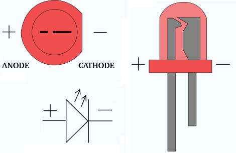

In terms of the kit, I would suggest if the option is available, to add polarity markers on the pcb screen for the LEDs. Anyone without much experience in building up boards might get caught out as the board currently seems to assume you can trace the circuit against the schematic.
Mark
Mark, on my boards the LED locations (D1-D4) are indicated via a circle with a flat edge on one side? I've always taken this to be a match for the flat edge of the LED or failing that the shorter negative cathode leg?
(Failing that look inside the LED and the cathode (negative) is the one with the little cup shape) Also if you look closely one hole is square - which I've again taken to means negative or cathode. Is your board different?
Of course I may be going mad...
RJBaldwin, you are of course, correct, but I can never remember whether the flat side is Cathode or Anode so I am guessing there are other idiots like me out there who only dabble in this foolishness and need things spelt out as clearly as poss.
Mark

Mark, I agree with marking the board for LED polarity '+", it certainly couldn't hurt, and I often forget which way round components go as well... so, no offence meant to you ;-) I only added the LED note so others would not have the same problem.
Russ

P.s. the + of led is the small (usually) anode side. On the board indication is a design "nice to have" but you should be able to this without problems on the pc board.
