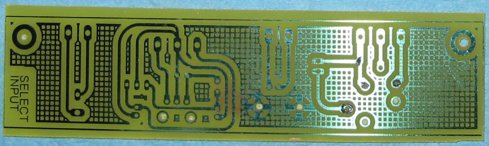

An a simple PCB, I called ''Digital Inputs PCB'' to go with the MUX 4:1 PCB. It allows the mounting of these connectors: AES/EBU Neutrik XLR female panel mount, True 75 ohms Amphenol BNC, Toslink TORX142L optical input (with needed parts, as the TORX PCB, and finally a RCA input. You can decide not to mount one of these and use the remaining MUX input to accept the USB interface, as I will do.

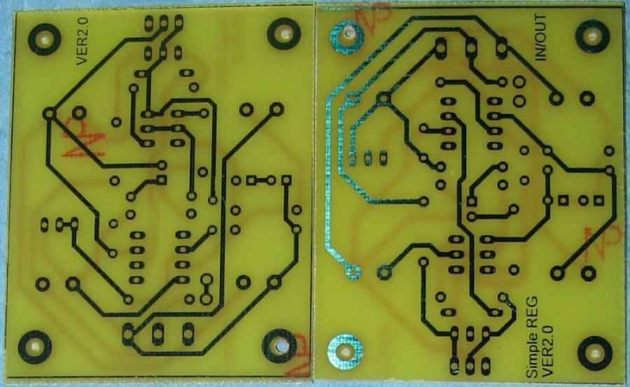

Algar_emi said:Just did the Simple Reg PCB for my Buffalo.
Sweet!
Let me know how it works. 🙂
I wasn't sure if anyone would try it.
Cheers!
Russ
Algar_emi said:An a simple PCB, I called ''Digital Inputs PCB'' to go with the MUX 4:1 PCB. It allows the mounting of these connectors: AES/EBU Neutrik XLR female panel mount, True 75 ohms Amphenol BNC, Toslink TORX142L optical input (with needed parts, as the TORX PCB, and finally a RCA input. You can decide not to mount one of these and use the remaining MUX input to accept the USB interface, as I will do.
We have actually discussed doing this sort of board. Good job!

Personally, I wouldn't do this but mount the connectors as close as possible with short equally spaced wiring to keep impedance as consistent as possible.
A pcb like this is likely to introduce variable impedance discontinuities.
You can se the differences on a fast scope.
