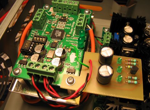

Fran, has the flat layout altered the modulation of the power supply lines ? I'm considering going "flat" here, or at least putting in a horizontal ground plane full wall-2-wall in the enclosure.
This means I could make a digital section in the top and a analog one in the bottom. Just don't have allot of hight to play with. 🙄

I only ever had them laid out flat - my case is a recycled one from a video switcher from a studio. FWIW, the case is 1U I think, just about 30mm high. I had to shorten the standoffs a little, they are about 5mm high. Everything fits fine, in fact I am about to start a second one for a friend the same way.
I don't know about the noise, I never went to the bother of measuring it! If you can tell me what to do with an oscilloscope I have a 100mHz one here that I can use (not that well versed in oscillscopes!).

Define very large pls. I'm now using 470u for C1 and C2, they fits the layout better than my previous 1000u. I have some 220u here as well...
Well the value is not as important as the inductance and ESR. Both should be low. Both of these usually correlates to case size. Generally the smaller, the lower the inductance.
Check the datasheet.
If you are not seeing any funky oscillations etc then your OK. 🙂

Thanks for the warning. What I had done was to add 22uF smt Murata ceramic to C6 and increased Vref output cap (Sanyo OSCON 100uF + Rubycon ZA 47 uF). There is no oscillation but the key in further improvement is the 47 uF. The corner F is now < 1Hz. I may increase capacitance 50 uF at a time and listen.
In my case the feed is already from a feedback ALW regulator with pre-reg fed from the LCDPS.
Another thing, the sound of the Ivy seems sensitive to supply voltage. I have reduced this from 14.7V to 13.5V +-.
ps; The Buffalo Ivy should be laid flat.
For anyone worried about LC ringing (tank circuit) using a cap with significant ESR will damp it. Tantalums will work well. Alternatively use a resistor in series with the cap to form a snubber.
Caps like Oscons/Pana FMs have a bigger chance of ringing.
