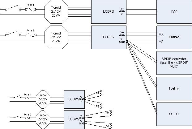

Hi all,
Hope you guys can help me with two basic questions:
- What load can I expect on the PSU-boards in the Buffalo configuration as in the attached image, and what size fuse (slow blow?) should I use for each on the primary side? Perhaps this info is already out there somewhere, if so, I have not found it.
- The lower setup in the image shows a simple test rig loading the PSU-boards with power resistors. I take it this is a simple and reasonable way to test the PSU-boards before hooking them up to the real consumer boards. Rx in the 100 ohms/5W range? The idea is to simply measure the output voltage and trim each LCxPS board using the variable pots on board to:
LCDPS VA 6.6V
LCDPS VD 6.0V
LCBPS 12.0V
Dex
LCDPS VA 6.6V
LCDPS VD 6.0V
LCBPS 12.0V
Dex

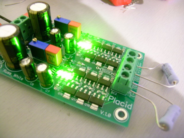

Russ White said:It is a dual shunt regulator which is rated at 200ma with 3V - 16V adjustable outputs. It can be configured as a bipolar supply as well.
I chose the name Placid because it is designed to be a nice quiet power supply.
Cheers!
Russ

The mains fuses can be very small - the transformers are only 20VA, and the circuits load them very lightly; none draws more than a couple of watts. As you are based in the 230V part of the world, the current in the primary will be much less than 0.1A.
I would probably use a 0.25A fuse; although lower values exist, they are not so easy to source, and I have heard accusations that they are not very reliable.
